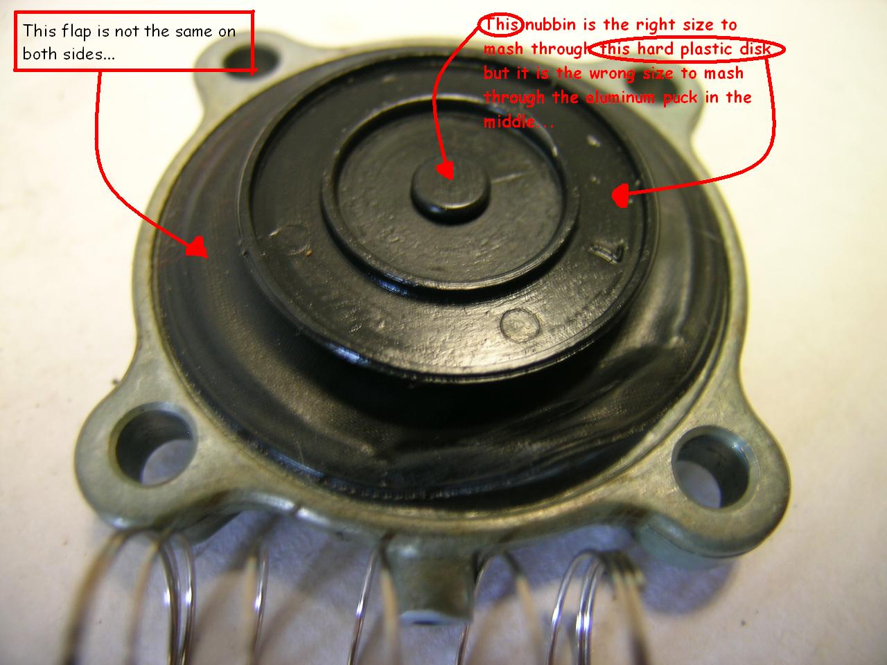

I've used wd-40 or alcohol as a lubricant before. I've seen
them put back together wrongly too... The flaps or diaphragms
are fragile too, it would be easy to damage one while struggling
to reassemble the petcock... There's some good
pictures floating around on this site that show all the proper
orientations. I made this a long time ago...
