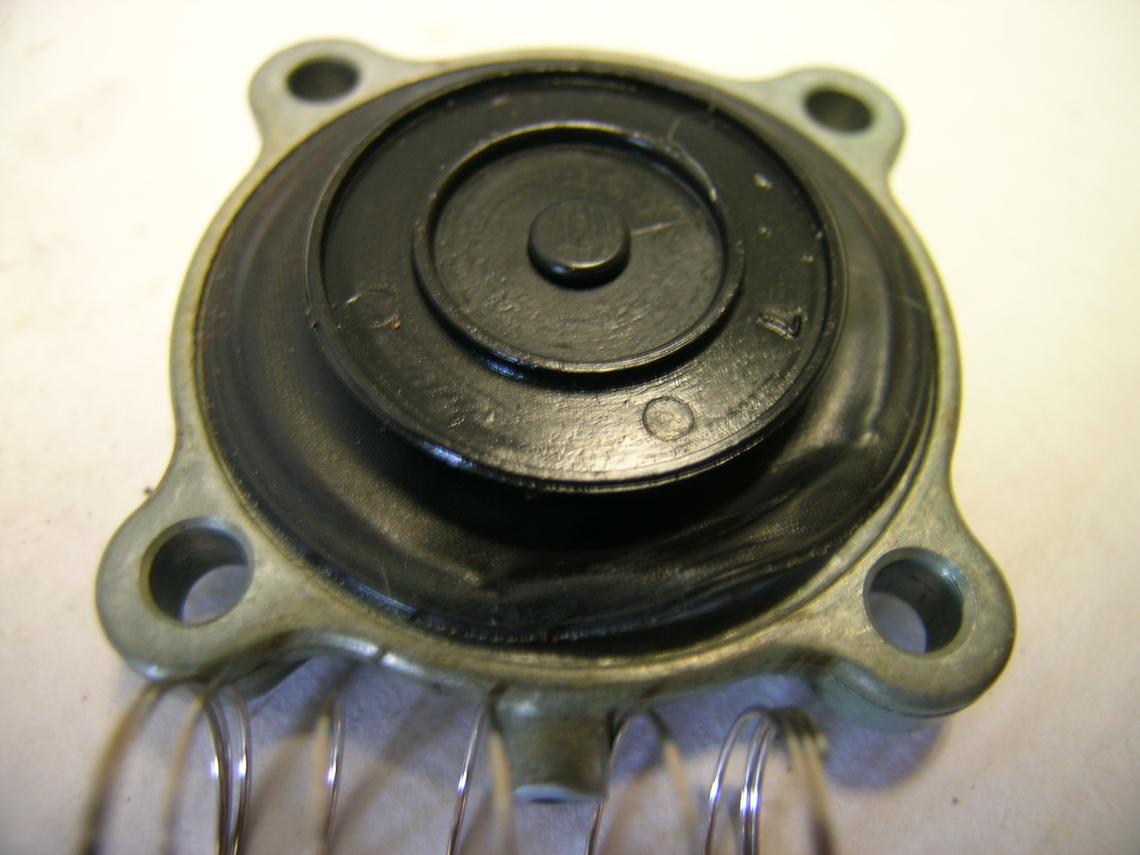

You'll need to check your petcock, that's probably what it is, and it is
bad for valkyries to have a non-functional petcock because it can
lead to engine damage - if one of your top-ends fills up with
uncompressible liquid and you hit the starter KAPOW!
There's a vent in the OEM pipes in the place you describe the gas
coming out. Exact same thing was happening to a friend of mine.
We fixed his petcock and that fixed the problem. The OEM repair kit
is a "cover set", it includes that wrinkly diaphragm you see in the
pictures and a few other bits.
