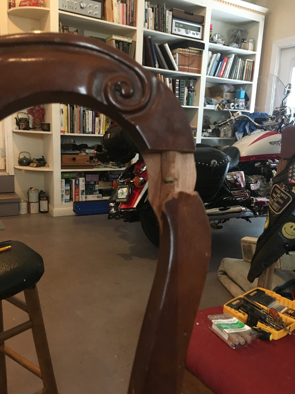

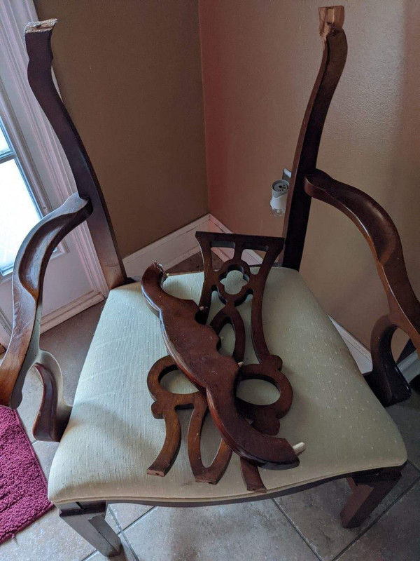

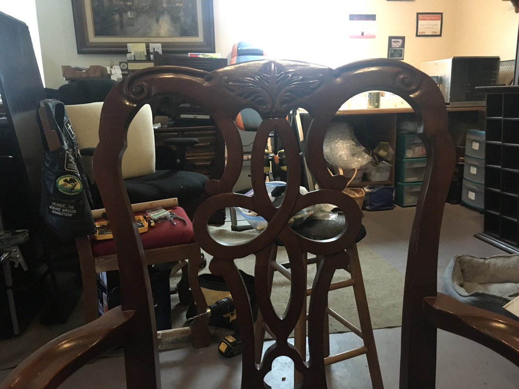

A new customer presents me with a busted up family heirloom chair. Seems two of her sons were wrestling and well you can see the result.
So most of it is straightforward. Dig out a couple broken dowels replace them and epoxy back together. Except there is a crucial piece missing

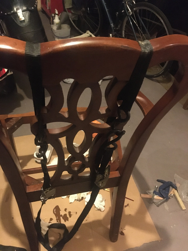

So the epoxy is drying, straps will come off in the morning

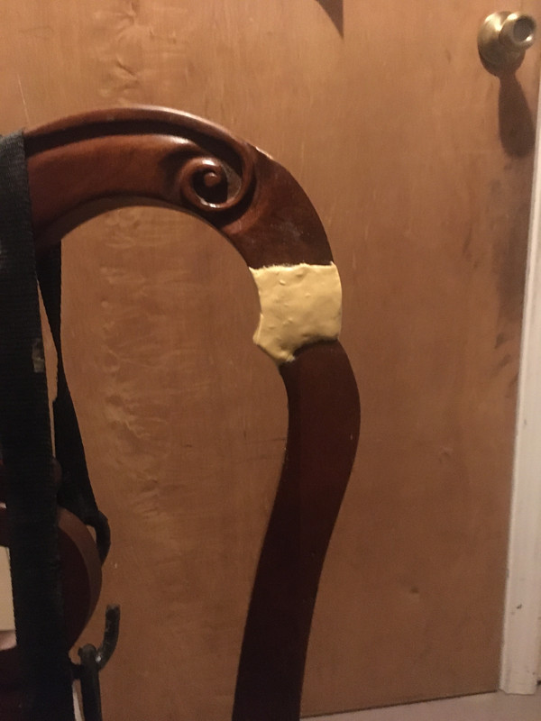

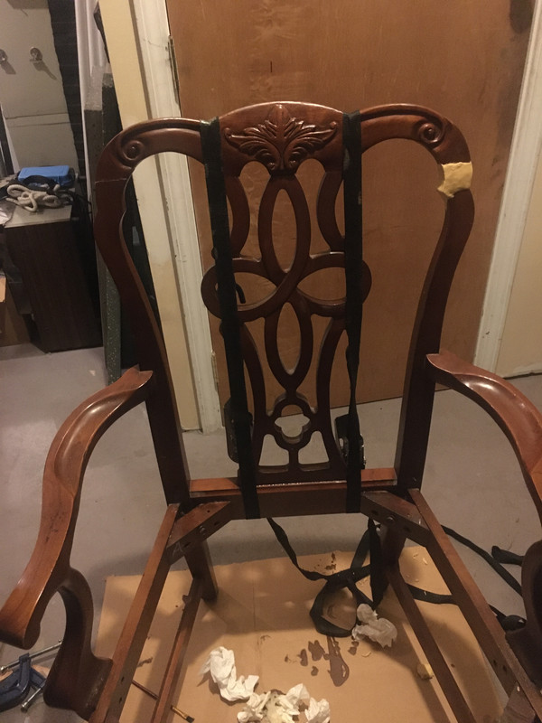

So I just got done sculpting some epoxy wood filler. Tomorrow I get to sand it to perfection and then color match the stain.
More to come

What kind of epoxy or whatever did you use... this stuff
is great, I think...
Posts: 14933
« Reply #2 on: December 28, 2021, 05:17:27 AM »
o
This is a two part epoxy filler that can be molded like clay. It’s very easy to make complex shapes. The two products are probably very similar.

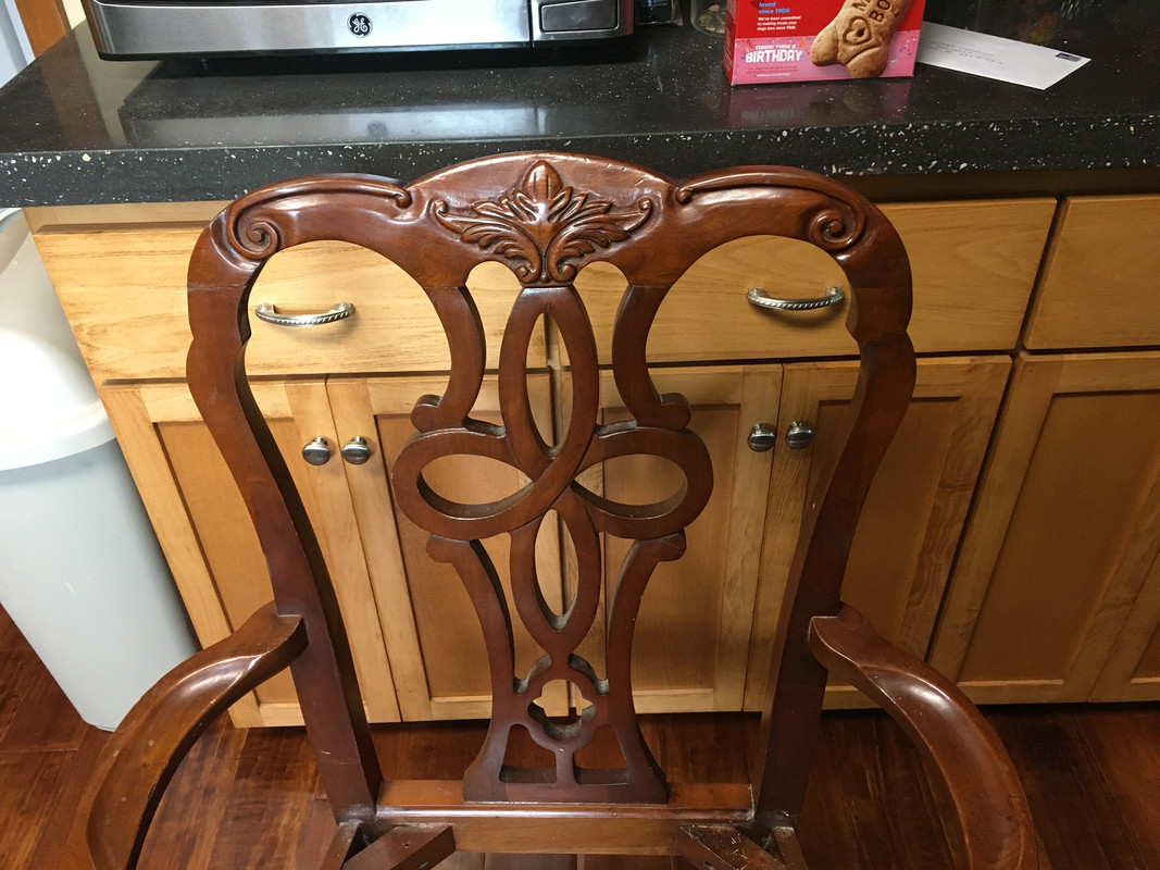

Well. Artistic sanding and staining finished for today. The hard part is getting the color right for after the poly coat because it all changes. I think I’m close
As it’s drying it’s blending in nicely. After I spray with poly it should be right on.

A slight touch up this morning and I think I’m there. This is it

Nice craftmanship.
Posts: 11830
« Reply #7 on: December 29, 2021, 08:28:50 AM »
pretty darn close to perfect as OEM.  Can still see the color difference of the patch but hardly at all.  Much better than I could do for sure.
Posts: 14933
« Reply #8 on: December 29, 2021, 08:30:57 AM »
I know but looking over the rest of the chair. The same two colors contrast in multiple places so it seemed like I should let it be.

« Reply #9 on: December 29, 2021, 10:01:41 PM »
agree totally is solid and able to use that is what matters the most

Are the other places due to the original pieces being from different pieces of wood?
Looks nice!!
Looks nice!!
Yes. But it’s the lighting that exaggerates the contrasting colors it looks right as can be.
