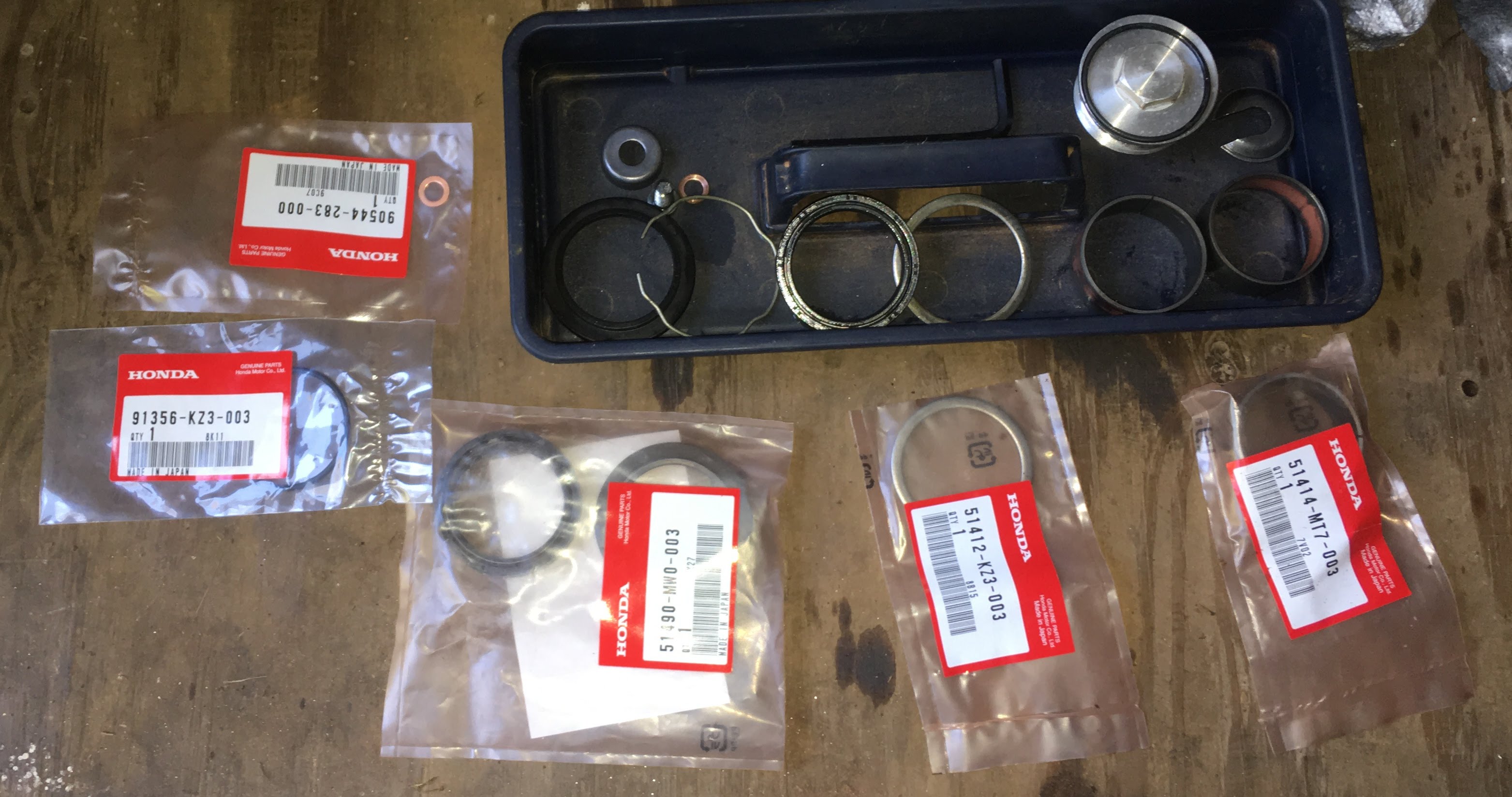

I wish the manual was still on line somewhere... the wear parts are listed in it...
Here's a picture of them...

Twofeathers, there are 4 mandatory items for each fork (orange, below). Even though
the forks are different mechanically, the wear items are the same both sides.
21 & 28  are absolutely necessary. 21 is the fork seal set (oil seal & dust seal). 28 is a new
             o-ring for the fork cap.
9 & 10  are bushings. Only necessary if the bushings are worn. However, I doubt they're
            being manufactured any longer so you might buy them in case the oem stock runs out.
The items in Green are maybe items.
17  is a retainer ring for the oil seal ($5). It's only necessary if your retaining ring is rusted.
     On our inverted forks, water can't flow uphill and seep under the dust seal against gravity.
     But it's worth an inspection because moisture can still get trapped in there. On non-inverted
     forks any water that get under the dust seal puddles on top the oil seal below the dust seal
     and the retaining ring can rust out and loosened rust particles can damage the oil seal.
16  is a piston ring for the Right fork collar tube. It's nylon and $14.
26  is a washer some what like the banjo bolt washer. You only need it if you plan on removing the
      damper on the Right fork. I don't suggest doing that though because the damper is discontinued
      and if you screw up the damper, it's difficult to replace.
29  is those chrome buttons for the lower fork pinch bolts.
