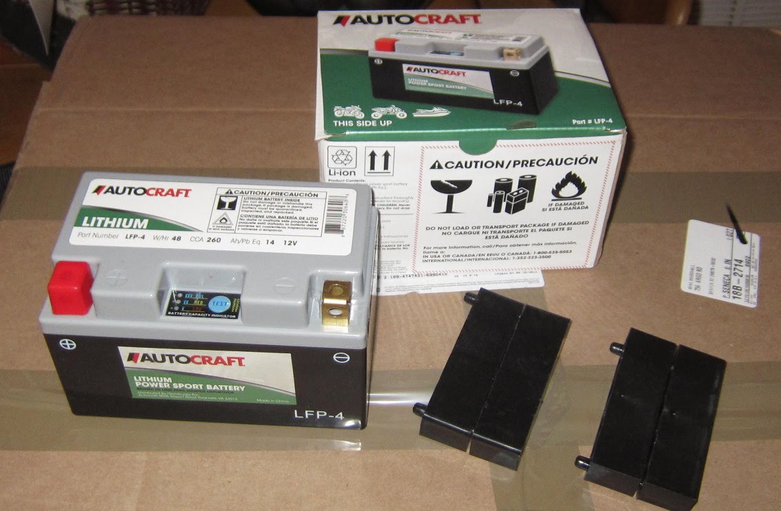

Since it was time to replace the battery, decided to go Lithium.  Installed the NOCO Lithium NLP14, 500A Lithium Powersport Battery.  Also had to get a new charger since regular chargers can't be used.  Went with the NOCO 5W Battery Charger, although they do offer higher output versions that can charge it full in about 24 mins!  Total cost about $200.
Right away I noticed much stronger starting power... even on the cold mornings!
Installation was a breeze.
A few things I like:
-Adjustable Height: Battery is the same footprint, but only about 3 inches tall.  They include a combination of different 'spacers' to snap on the bottom to adjust the height. VERY Convenient!  I set it up so it'd be about about 3/4" lower than before to give a little extra room for installing the battery cover.
-Multiple Post mounting options:  Each terminal has 3 sides for bolting cables. VERY convenient!
-Higher amps (500a vs the normal 200CCA)
-Slightly higher min voltage:  Lithium provides a higher minimum voltage than lead acid types.
https://no.co/nlp14
Hope this helps!
Cheers,
Jersey

Another (serious) question. Lithium batteries require a special charger but most of the I'd be charging it with the old-fashioned Valkyrie charging system. And this works okay? The battery looks good but I typically get 5 to 10 years out of an AGM so I won't be in the market anytime soon.
Jersey
Posts: 545
VRCC #37540
Southern Maryland
« Reply #21 on: January 31, 2022, 03:06:20 PM »
The bike's charging system does work with Lithium... at least on mine.
Same here. Did fine with regular batteries, but it finally died.
Cheers,
Jersey
Jersey
Posts: 545
VRCC #37540
Southern Maryland
« Reply #22 on: January 31, 2022, 03:29:14 PM »
I have charged mine with a regular charger. No problems. I think there are different kinds of lithium batteries. Some probably require a special charger.
As I understand it, Lithium requires a higher charging voltage...  While the motorcycle produces this when running, the standard battery chargers may not have this.

« Reply #33 on: May 14, 2022, 06:46:02 PM »
  I just read the caution sheet on the battery. It says not to get it wet.  Did I miss read. I have been in rain storms that were wetter than a swimming pool.
what about washing the bike.  I need a battery and after reading the caution sheet , those that use them should be able to answer.
                                             da prez
da prez
Posts: 4454
Wilmot Wi
« Reply #34 on: May 14, 2022, 06:52:41 PM »
  i just did a search on the battery.  Fresh water has little effect. Salt water will quickly damage the battery. The batteries should not be left wet.
  I should have done more search before asking.
