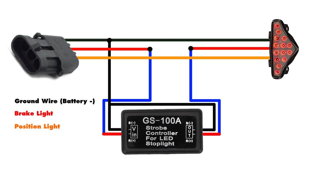

« Reply #13 on: March 21, 2022, 01:49:43 PM »
  This might help.
I don't have any blue wire  Grin
