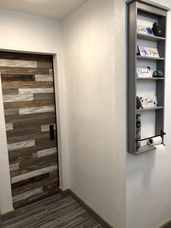

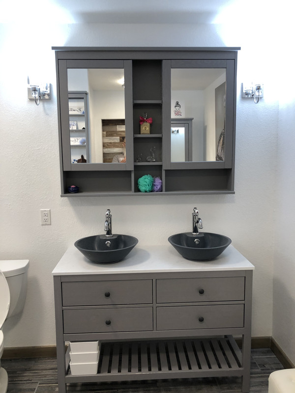

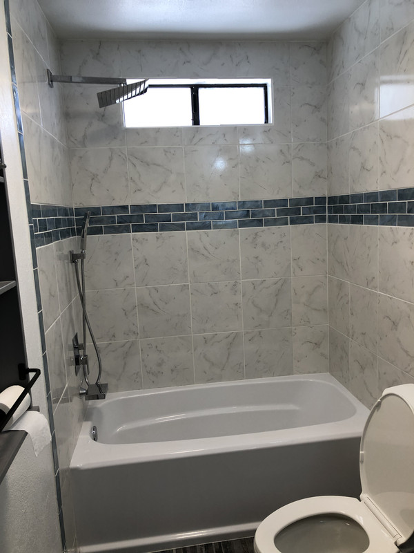

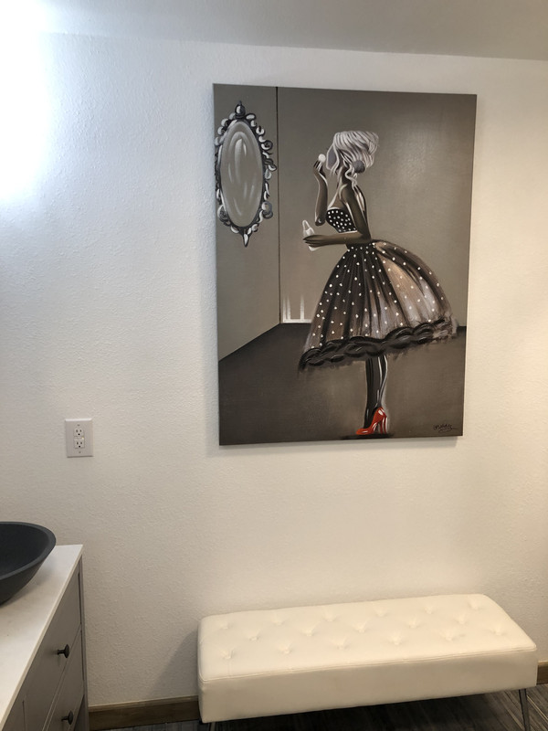

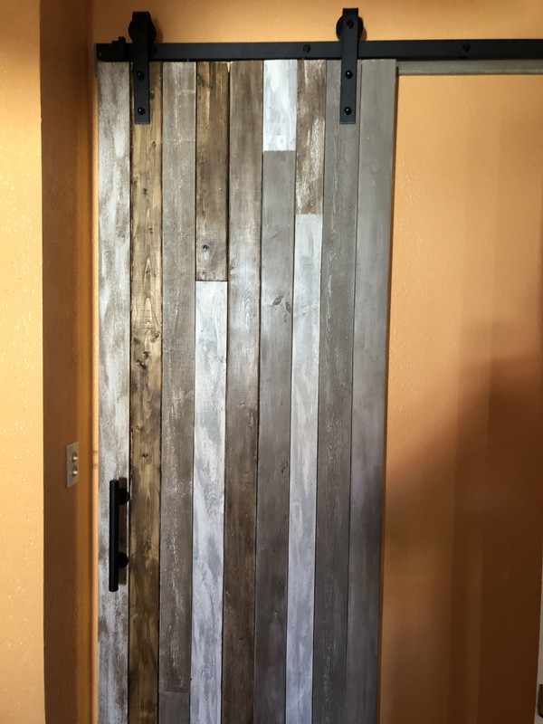

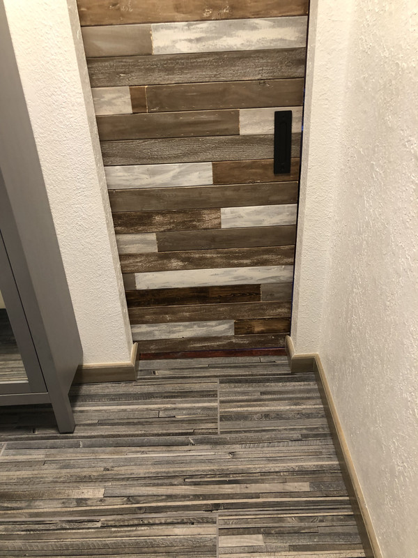

Finally finished a week ago. I really liked the door and tile.

Very nice, you wanna come do mine next?
One question - does the door have a lock? (Dad of 4 is interested in details like that. Had a hotel with no lock on the bathroom door, I prefer to poop alone, not with company! Wink )

Just jam a small wedge in one of the overhead door rollers.  cooldude

Thanks, probably not.  Wink No lock, it’s just us 2, and this bath is part of the master bedroom. (But I’m sure a lock could be added easily enough)

Thanks, but I can’t take credit for colors or fixtures. (Although I did design the door and it’s colors)

You ain't done till you hang the tp.
Leaving it on the shelf is a no no.

nice, but isn't the TP holder across from poddy too far to reach comfortably?
that big showerhead looks like a TV wall mount.....  Grin

Nice Job, like the door and tile combo, looks really good. cooldude

Nice job! Liking the color scheme and the use of larger tile in the tub surround. I don't see a HGTV designer bathroom.  cooldude  Grin Again good job.

From a 36 year technical person/trainer in the tile & stone industry, I commend you on what looks to be proper layout, cuts and edge profiling of the tilework cooldude

Thanks, but there are plenty of mistakes. You just can’t see them very well in the pics. In picking out the tiles, she found some good tile for the floor in Vegas. But she couldn’t find anything she liked for the tub surround. She finally decided on some at our local Lowe’s dirt cheap. After starting the tub surround I found why it was so cheap. There were differences of a quarter inch in dimension. Which I’m sure you know makes a tiling job VERY difficult. I also didn’t realize that half of one box was a slightly different shade until I started grouting. But at that point I wasn’t about to remove them and redo it. Thank God she picked the tile, I’d have never heard the end of it.  Grin That was the most challenging tile job I’ve ever done. The old saying “you get what you pay for” is pretty apt.
(I also think a proper layout would have been to center the back wall, and take cuts off of both ends)

Yes, as with anything, you get what you pay for. For that size tile to be that far out on size consistency, it must have been a real good deal Wink
And yes, the ideal way to lay out that back wall would be to even out the two end tiles, but if you leave more than 50% of a cut tile at one end its considered acceptable.
