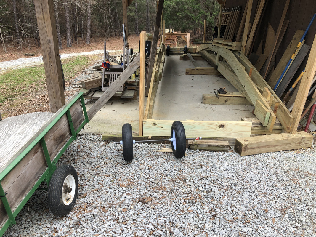

I have a trailer but it is not long enough.  I have considered sliding them into the trailer and and finding some way to support the part that's outside the trailer (over half length).
Maybe a 2x6 with a metal rod and two wheels.  I build a tailer about 15 years ago that way.  No suspension just a shaft and wheels.  Only used on the property.
The issue is/would be the terrain is rough down to the creek.  Its all downhill but.... its not paved or graded.

Jess, and others.
I have looked and found, what I sort of expected to find, that I can buy something like 13.5" wheelbarrow tires.  They take a 5/8" shaft.
I guess I could simply put the shaft under the truss.
One other thing just entered my mind.  I could drill a single 5/8" hole in each truss and then mount the wheels on each side.
I don't think the single hole would affect the strength.
I can get the 5/8" steel shaft from Lowes.
Collars for locking the wheels on have not found yet.

« Reply #10 on: March 23, 2022, 01:05:52 PM »
This is exactly what I had in mind suggesting wheels.  A hole (or several) in the truss will not affect strength, only looks.
Although I was thinking to mount rear wheels only with two guys to lug the front, taking breaks.  Rear wheel maybe not mounted at the end but far enough forward the tail doesn't drag, but it reduces weight to be carried, and makes pivot more efficient.  The taller the wheels, the further forward the mount, the less weight to carry.  Mount a temp crossbar in front for a guy on each side to carry.  Wrap padded shoulder straps over the crossbar to get weight off the arms.  Just like horses in harness.   Grin
A couple pair of big vice grips might substitute for collars.  And grease.
And this is a job better done in cool spring than murderous summer.

Think I have found the parts, have to go to two different stores (Tractor Supply).  I think I will get the wheels first (from a local Western Auto here in town) and verify they will work.  I will ask that I be allowed to return them after I size them up on the truss.

I went out today to purchase some "stuff" to use for wheels.  Wheels for a wheelbarrow, 5/8" steel rod for an axle and 5/8" shaft collars with set screw.   The latter cannot be found well I did find five (5) at one store and one at another (both Tractor Supply) and there is another Tractor Supply about 20 miles away that is suppose to have two. I would like to have 12 total.... So I can have two wheels but....
In light of the lack of shaft collars I believe I can feed one end of the truss into the hitch assembly that is attached to the tractor's three point hitch and find a way to lock it in place and using that and the wheels, should make it easy to move about 2/3s of the way to the bridge area.
Photos below.

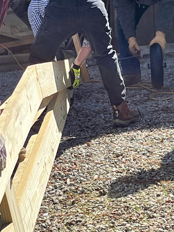

Bridge construction day!!!!   Four friends (three co-workers and one son) from work (all retired as I am) dropped by today to help me build the bridge.  Actually they did 99% of the work.
The wheeled trolly thing was really great even if it did cost $150.   We did not get all the planks installed nor the side rails but, as you can see from the few pictures below, the thing is very sturdy.   It was impressive to see it actually go together as planned.  And yes, I was a little surprised.   I was completely ready for it not do so.
Anyway,  there is still some work to be done, installation of all the planks, building the side rails but it is up and very, very sturdy.

Very nice work.   cooldude    nice pics (and friends) too
That thing is the proverbial brick sh!thouse (and I mean rock solid).
It seriously looks like when completed someone with a Mini Cooper could drive over it.

Jess, it was impressive to watch it go up.  Even though I had looked at the YouTube video many times, I was losing sleep over concerns.  It looked to good to be true.
But the design was/is good.  And they were all impressed the way it went together.  I have to finish the "planks" and put on the guardrail.   Then I will walk across it.   Cheesy

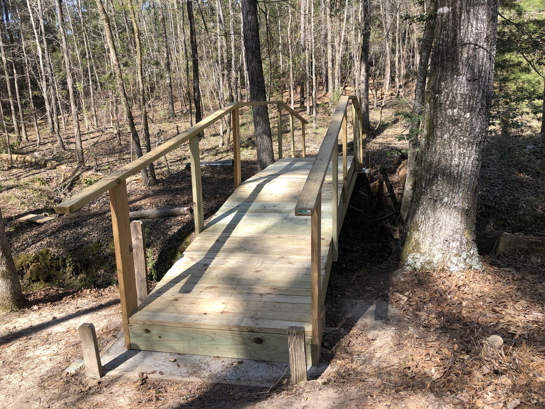

Did some more work today on the bridge.  Got 95% of the floor done, installed the main uprights for the rail (more to add for middle support) and added the rail on top.
So, the wife took her fist walk on the new bridge (link below).

The bridge looks great. Looks nuclear grade!

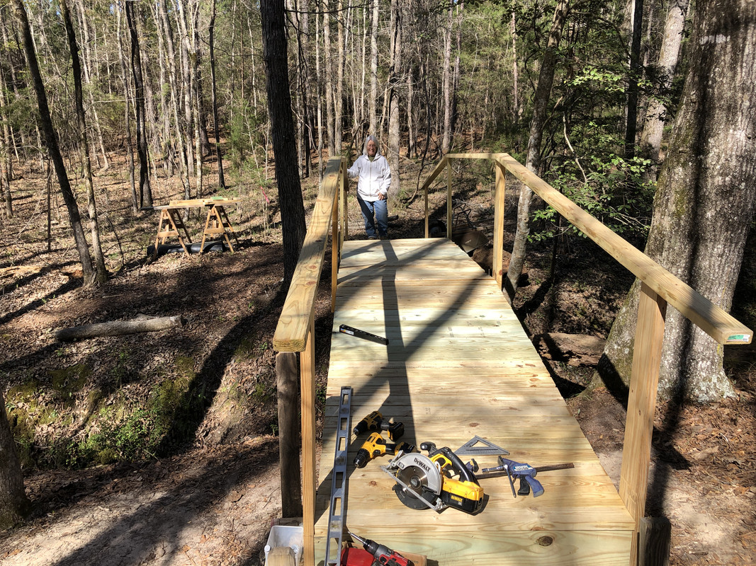

Today I went out and installed 99% of the tread boards (for lack of a better name).  Each board will have five screws (two on the outside and one in the center) but I only got three in each board today.
Also have three more boards to install at the far end and one narrow board at the transition point on the close side.
Put some hand rail supports in and will add two smaller supports (1x4's) on the center hand rails.
Oh, and I have to trim the ends of the handrails.  Not sure how long I want them beyond the vertical support. I did wheel the wheelbarrow back across with a few things inside.  All worked well.
