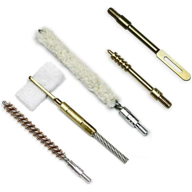

Well, almost.  I inherited an Italian Carcano rifle that is very similar in style and year of the Carcano Oswald used to shoot Kennedy.  The rifle is in OK shape.  Everything is present including the strap.  There may have been a bayonet at one point but not now.  The bolt moves as it should.  I very lightly cleaned things with WD40 and all seems in working order.  Looking down the barrel, though, it looks a little rough.  It could just be surface oxidation.  Can anyone recommend a solution or cleaner that I can use to clean the inside of the barrel?

If the cleaning rod is good, all you need is a brass brush and patch holder and some cleaning patches (that should each screw to the end of the rod), and some bore solvent.  If the original cleaning rod is unthreaded for cleaning tools, you will need a modern cleaning rod that is (one piece is better than multi pieces).  Get one long enough for the barrel, but not super long as this is like working with a fishing pole.
Remove the bolt (from the rear), and clean from the breach (not from the barrel).
The Carcano was 6.5mm, so you need a brush for .26 caliber.  The picture is a full size/length rifle, Oswald used the shorter carbine Carcano (I think).
Bore cleaner CLP (clean, lube, preserve) is good for clean and oil of whole rifle.

This is good information, thank you!  The rod is a one piece thing that is threaded on one end and has the elongated loop on the other.  It slides into its tube and then screws in securely.  If I keep the rifle, I will definitely get a better cleaning tool.
