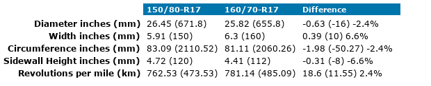

Questioning will it fit, will it ride, will it decrease handling, will it rattle my teeth, will it be the long riding tire I'm looking for?  I'm feeling like a test pilot.  What are your thoughts?
The front Avon has a few mm left before hitting the wear bars, but it probably won't be long enough to last the entire summer.
So with the supply chain ready to cater.
I jumped the gun and bought a Rear Commander III Cruiser in 160/70/17 for possible replacement of OEM front 150/80/17.
The tire comparison spec guide put it at 0.4 in. wider, and minimal decrease in diameter.
The of course the whole Bias tire thing with radial light truck tire in rear.
Im sure there is some insight here, fire away.
Thanks again.  Tom

Speedo Reading   Actual Speed on the OEM stock -5%,  Right 160/70/B17
20 mph (32.19 km/h)   19.52 mph (31.42 km/h)
25 mph (40.23 km/h)   24.4 mph (39.28 km/h)
30 mph (48.28 km/h)   29.29 mph (47.13 km/h)
35 mph (56.33 km/h)   34.17 mph (54.99 km/h)
40 mph (64.37 km/h)   39.05 mph (62.84 km/h)
45 mph (72.42 km/h)   43.93 mph (70.7 km/h)
50 mph (80.47 km/h)   48.81 mph (78.55 km/h)
55 mph (88.51 km/h)   53.69 mph (86.41 km/h)
60 mph (96.56 km/h)   58.57 mph (94.26 km/h)
65 mph (104.61 km/h)   63.45 mph (102.12 km/h)
70 mph (112.65 km/h)   68.33 mph (109.97 km/h)
75 mph (120.7 km/h)   73.21 mph (117.83 km/h)
80 mph (128.75 km/h)   78.09 mph (125.68 km/h)
85 mph (136.79 km/h)   82.98 mph (133.54 km/h)
90 mph (144.84 km/h)   87.86 mph (141.39 km/h)
95 mph (152.89 km/h)   92.74 mph (149.25 km/h)
100 mph (160.93 km/h)   97.62 mph (157.1 km/h)
