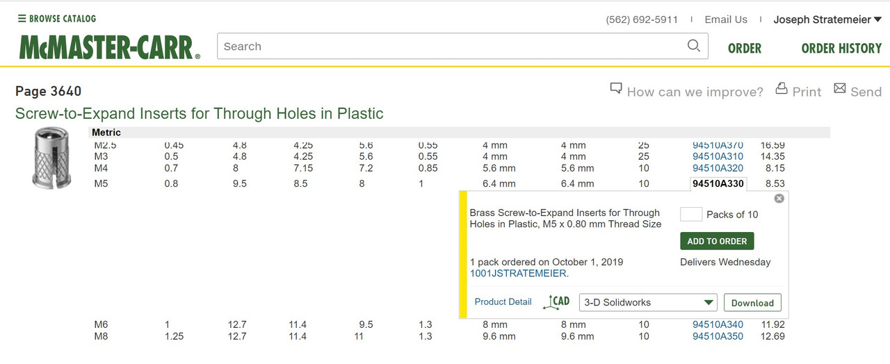

Posts: 8753
« Reply #10 on: May 28, 2022, 04:23:19 AM »
I ordered these on line at McMaster-Carr mcmaster.com
The last repair I made I used epoxy (JBweld), but for other repairs I have used superglue and baking soda.  There are several youtube videos showing how it's done.  I suggest watching as it may come in handy even if not in this situation.
« Last Edit: May 28, 2022, 04:27:09 AM by Skinhead » Logged
garyheskett All 49 x 3 st.louis
Posts: 137
St. Louis, Missouri
« Reply #11 on: June 01, 2022, 07:08:20 PM »
Thanks Skinhead.  I forgot about McMaster.  I got the little screws (Allen) for the clutch and brake reservoirs there some years ago. I had forgotten about them.
