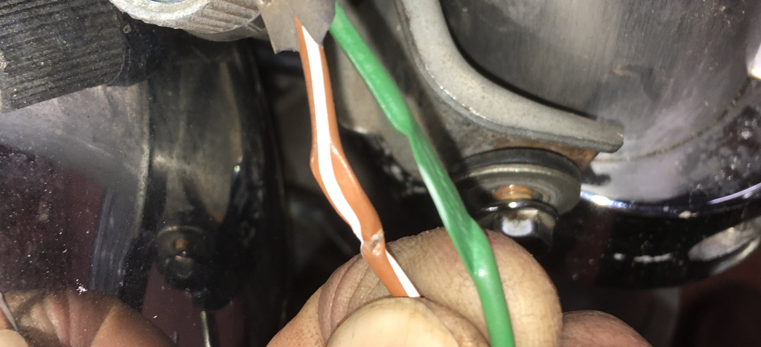

The way Ruby's popping fuses.
Had a BigBF horn system installed.  Couple days ago I was riding by the lake and came upon a group of sheep chowing down on the grasses by the road.  I was gonna blow 'em away from the road, so to speak.  NO JOY when I pressed the horn button and heard nothing.
Thinking it was a fuse, I switched out the 15a inline fuse and tried again.  POP!  Looked over wiring, nothing obvious.  Tried a 20a.  Pow, with a visible spark in the fuse.  25a, no go.  Should I try 30?  Sure, why not?  POP!
The garage queen Silver Bullet also has a Big BF horn.  Come to think of it that one was installed by the man himself in Spearfish.  I looked at that setup, similar except it was rigged with the positive power coming off the big fusible fuse.  I've never had any problem with that setup.
So, now I'm thinking I'll duplicate that and try the fusible link for Ruby's horns.  Anyone else seen horns or accessories running directly from that big fuse?  Any reason I shouldn't give it a try?

Everything on my bike runs through a single fuse box (breaker box really)
that is made hot by a relay hooked to the accessory wire behind the side
panel. I hate the idea of splicing in at arbitrary places.
When my bike was popping various fuses, I studied the wiring diagram
in the manual and traced down all the places that circuit went. I found
a shorted out place where I'd pinched a wire with my windshield bracket.
So... I'd guess that if your stuff was wired fine before, it is still fine, and
maybe you need to look for a short somewhere.

?.  If it's blowing inline fuses from power to the relay, could that indicate a bad relay?  I hate electrical stuff.
Posts: 10517
« Reply #8 on: June 05, 2022, 01:23:27 PM »
Yep.  It was a bad 5-way relay.
