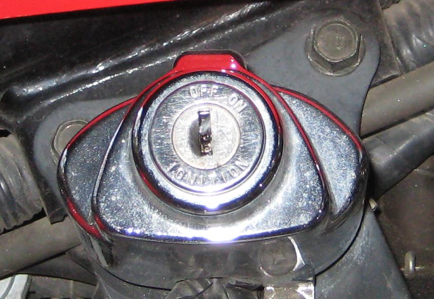

Tried to start my 99 today and the key won’t go in.  Looking at the ignition, the small cover is slid over and it looks like a small bar across in inlet blocking the key from inserting.  Any ideas??

Gotta remove it. Use a small pic

I shot a little graphite in it and tried a pic, couldn’t get it, guess I’ll have to try a little more

Try a paper clip. Straighten it and make a tiny hook at the end

I just had the same thing happen to me.  I was able to move the piece back over with a small pick.  Sprayed some "lock ease" graphite in and seems to be okay now.

Both my bag locks did this. One went back in place and works the other came out and works fine.

also, there's a coil spring (return spring), that's just about the right size to get shoved into the key slot.
Another option is to remove the chrome cover (single screw 13). Absolutely, nothing can go wrong.
Item A is friction fitted to the keybox by a barb and dimple. Item B is just a cap, so forth. The keybox does not have to be removed as pictured. Not necessary.
