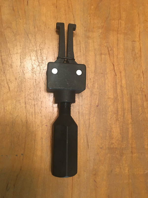

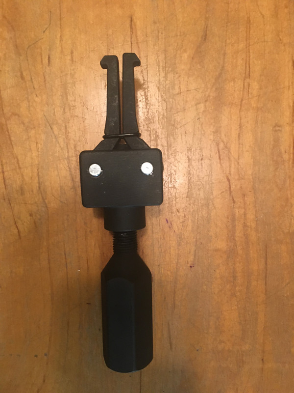

For removal. This is the best I have ever used.
Looks like this for pilot bearing use
I ground the fingers to a point for wheel bearing removal
$30 at O Reilly’s Auto Parts. You do have rent the slide hammer. Here it’s a free rental.
Chris,
I have the slide and bearing puller adapter from O'reilly's. I gave it a quick try but it did not seem to want to work. It does not grab the bearing very well. 1 or 2 smacks and out comes the tool and not the bearing.
I was worried I would damage the spacer inside if I was pushing those ears out against too much?

Yep same thing got me until I ground the fingers to a point. You have to carefully set the point between the bearing and spacer and then when you tighten it you can see the bearing move. Tap tighten tap tighten a couple times then you have it captured and it’s out like butter
