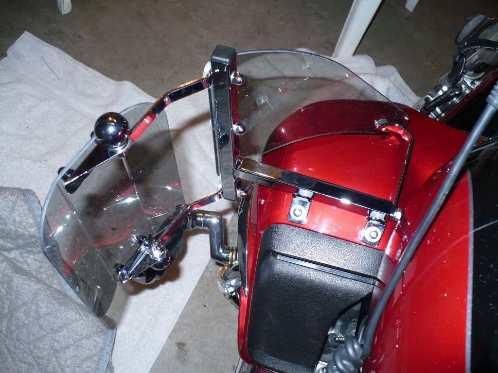

« on: January 21, 2010, 06:21:03 PM »
 The instructions were not very good and the pictures were just as poor. The bottom braces were marked left and right but the part I'm questioning is the outside wing, they could go either way and they were not marked so I'm not sure if there on correctly, anybody know?

« Reply #1 on: January 21, 2010, 06:33:03 PM »
No it does not look right to me.  I just do not know what it should look like.  The idea of the wing going in front of the tank is different, might be good.  I do know that the panel on the side doesn't look like it will work.  Good luck with this one.

« Reply #2 on: January 21, 2010, 06:44:51 PM »
That don't look right I looked around my pictures and found a few but they don't show them that well.I can get you some detailed pic's tomorrow if needed.

« Reply #4 on: January 21, 2010, 07:30:02 PM »
Rod, it appears you need to reverse the mounting position of brackets attached to the plastic. I just took these shots of mine, hope they help. Notice the difference....the wide end of those brackets go away from the post.

« Reply #6 on: January 22, 2010, 06:59:59 AM »
They are definitely not installed the way they should be. Mine look exactly the same as John's. Sorry, I don't have a picture though.

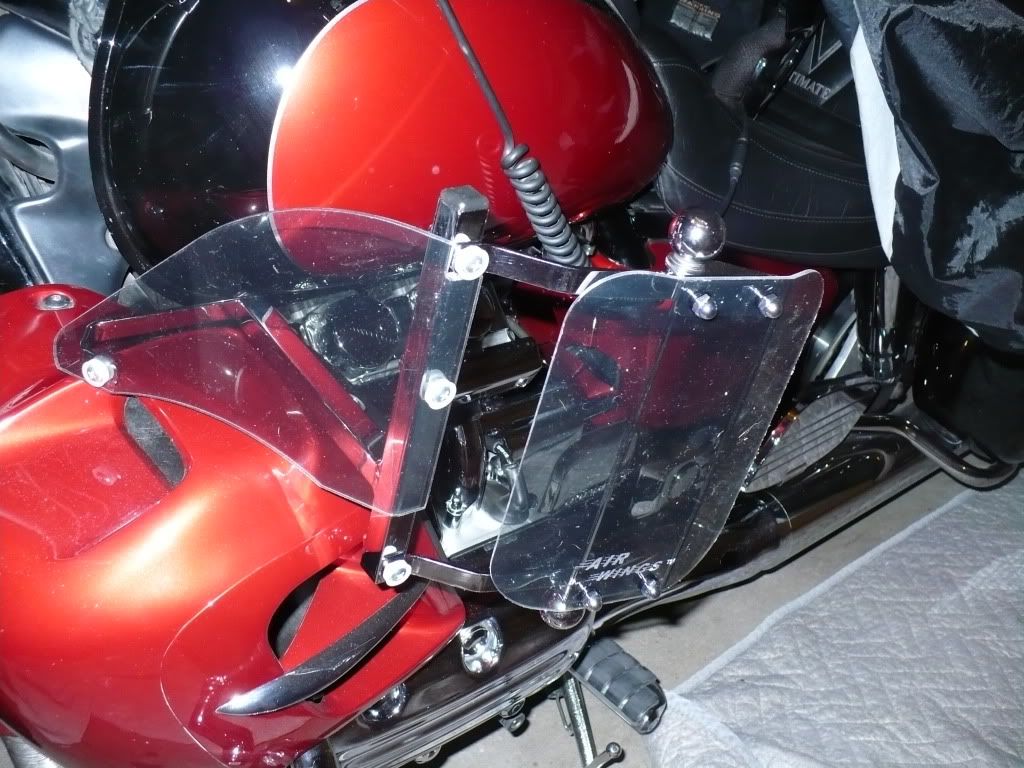

« Reply #7 on: January 22, 2010, 08:03:54 AM »
John beat me to it however I'm going to post my pic's since I took the time to take them  Wink

« Reply #8 on: January 22, 2010, 09:03:42 AM »
Here is a couple more pics Hotrod.

« Reply #11 on: January 22, 2010, 04:33:38 PM »
Its also possible they sent the wrong brackets thatsd what they did to me called them up and they sent the rite ones

« Reply #12 on: January 22, 2010, 08:27:08 PM »
When I first put mine on I put them together like you did and it just didn't seem right to have that gap.  I switched them and that was all it took to make them look like Smokin Joe's pictures show with no gap.  The long part of the chrome bracket need to point toward the front of the bike and not rearward.

« Reply #13 on: January 23, 2010, 06:03:28 AM »
Thanks guys for the great pictures and feedback,I'm gonna finish tonight after work but you know what I think they sent the wings with brackets backwards,not sure but at least I know what direction to go in thanks to you all.

« Reply #16 on: January 23, 2010, 10:44:34 PM »
The adjustable panel is upside down.  Just take it off and turn it right side up.

« Reply #17 on: January 25, 2010, 07:43:45 AM »
I don't think they're upside down... look at the first picture closely, The "Air Wings" logo looks the way it should. If they were upside down, the logo would be too.

« Reply #18 on: January 25, 2010, 08:54:50 AM »
I think you have the wrong brackets.  Look at your pic, then the next ones.  See how much longer the metal piece is that attaches to the wings on yours, vs the other pics.  Theirs are much shorter.

« Reply #19 on: January 25, 2010, 09:31:07 AM »
The triangle brackets attached to the "movable" deflector need to be interchanged.  Move the top to bottom...bottom to top.  The pivot point needs to be to the rear, not forward.  That's what I meant

« Reply #20 on: January 25, 2010, 01:22:09 PM »
If you haven't already done so just swap them to the opposite sides and the logo will be correct and the gap will be gone.

« Reply #22 on: January 26, 2010, 11:34:35 AM »
Well I've tried every way possible and I've come to the conclusion that the dog leg bracket that holds the wing must be too long,It's 4 3/16" end to end and every way I try It don't look like yours. I can mount them withe dog leg going in towards my leg but that doesn't seem right. I'm going to call them.

« Reply #23 on: January 26, 2010, 12:11:26 PM »
Well,I have them mounted correctly,Baker just called me back and the brackets are too long.Sending new ones.

« Reply #25 on: January 26, 2010, 01:26:10 PM »
Clint
I bet Baker sends you the same thing back again.  I agree with Clint.  Just unscrew the top and bottom round balls, then swap the panels to the opposite sides of the bike and you will be fixed up.

« Reply #27 on: January 26, 2010, 03:14:46 PM »
Clint
Sorry but that wont get rid of the gap between the wing and the front shield deflector at all,the new brackets are 2" shorter,they said the ones I have are wrong.

« Reply #28 on: January 26, 2010, 03:57:56 PM »
Clint
I agree... flip the outter adjustable panels to the other side and that should work.... even the Logo will be correct....   cooldude
Look at your picture, the pivot point is offset and I believe by moving the panels to the other side it will correct the space issue (just the outer adjustable panels) adn the logos will still be upright.  If you have not sent em back, it won't take but a few mins to swap sides on the panels for a check.

« Reply #30 on: January 26, 2010, 04:42:00 PM »
I think Steve K and Clint have the answer. Forgive my photo damage.
The triangle piece needs to point the opposite direction. Switching the
triangle pieces only top to bottom would accomplish moving the panel
closer to the vertical post and close the gap.
Look at the pictures Alph posted. You can see the triangles point the opposite
direction.

« Reply #32 on: January 27, 2010, 05:25:27 AM »
For comparison I took a picture of the wing bracket on my 98 Tourer. They may be mounted differently on the other models. I haven't removed the panel from the bracket since I've owned this bike. You can see it points the opposite direction as the one in question which would move the panel the length of the bracket.

« Reply #33 on: January 27, 2010, 07:10:34 AM »
Clint
I just went out and swapped mine from side to side and took the above pictures both ways.  I hope this helps you out.  You must have gotten ahold of a new guy at Baker or he wasn't following what was going on.
This only took me about 10 minutes

« Reply #34 on: January 27, 2010, 12:22:08 PM »
here is how mine look
however I took out the fixed piece last year and frankly I wouldnt put it back unless intending to ride all day in the rain or below freezing temps
