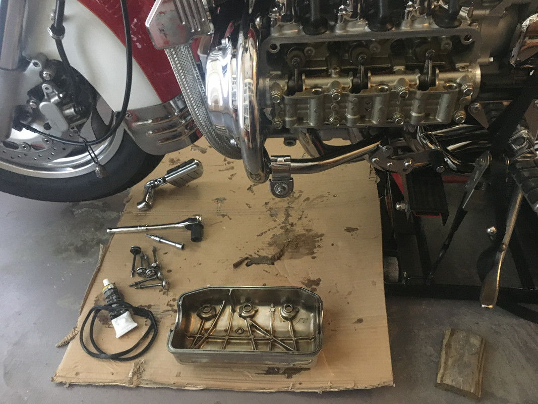

Ok so I’ve been having this irritating one small drop at a time oil leak from the left valve cover. I took it apart a month ago and thought it was only seeping out at one of the shoulder points where the sealant goes. So I cleaned it up and re sealed it. Another drop of oil today on the rag while cleaning after a ride. No drops ever actually dripped on the floor but eventually it could have.
So, today I installed a new gasket. If this doesn’t work I have to come up with a plan.

Well, it is probably too soon to know for sure but after yesterday’s ride there was no sign of oil after a vigorous try to find oil underneath that valve cover. I’m banking on the answer that it’s finally fixed.

  Chris , the inside of that valve cover is filthy. Are you slipping in your old age.  2funny 2funny
