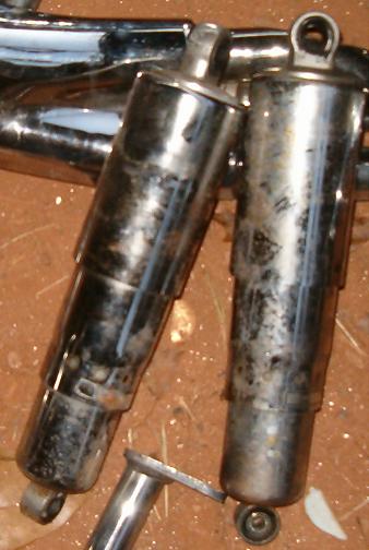

The manual lists all the wear parts, bushings and what not... The several times I've done it I just ordered the
wear  parts ahead of time so I'd have them all when the forks were apart. I think Progressive springs are
an easy giant upgrade to do while the forks are apart, too... there were a lot of tired rusty parts on my bike
when I got it, including the shocks... I got Progressive shocks right away and have always been glad I did.
I'm on my second set now... Bitubo brand shocks are good too, my friend got some from Traxxion (a Georgia
suspension shop) and they helped him get them sized correctly.
