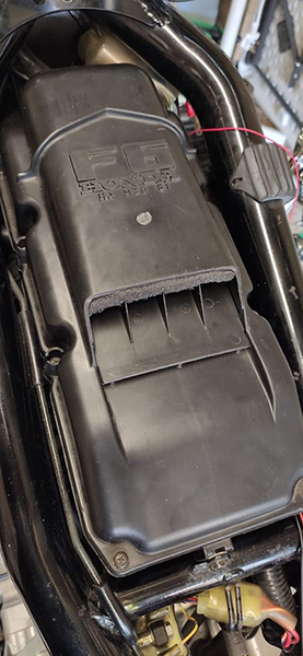

« Reply #5 on: October 16, 2022, 05:19:16 AM »
I take it you've checked the pre-filter is intact in the airbox lid. Runs super lean without it.
Yes I added the filter as shown below, the engine did not like it . . . . It started OK, but once it began to warm up and turn off enricher, it ran very sick with clouds of smoke. Removed it and was back to normal running, so can only assume it made it far too rich ?

« Reply #6 on: October 16, 2022, 08:43:14 AM »
That's WAY too much filter foam.
You have to use closed cell foam in dimensions 10x90x110mm
If you want to use the Cobras, you have to remove this foam and rejet to US specs(keeping the 35 slow, some say 38 and 100-105 Main jets)
Running Cobras  on EU stock carb and foam in air filter lid will be way too lean.
As you told you have two different exhausts, I'd recommend removing the smaller piggies on the EU silencer and rebuild it to the US pendant on the other side.
35 slow,100 main, no foam in lids and you'll get the best performance achievable, hands down.
Cobras will loose 6HP at least., You may not notice as your setup ist not Optimum ATM (to be polite...)

« Reply #7 on: October 16, 2022, 10:16:29 AM »
Whoa - that looks like 30mm thick. Slice it down with a bread knife job done.

« Reply #8 on: October 17, 2022, 05:20:48 AM »
So its not acting as a filter it's basically restricting/reducing the intakes air flow ?
steveB (VRCC UK)
Posts: 150
« Reply #9 on: October 17, 2022, 07:42:24 AM »
Yep restricts amount of air entering airbox. Allows leaner main jets. Most deteriorate in a couple of years keep an eye on it. Usual sign - bits of foam on top the air filter.

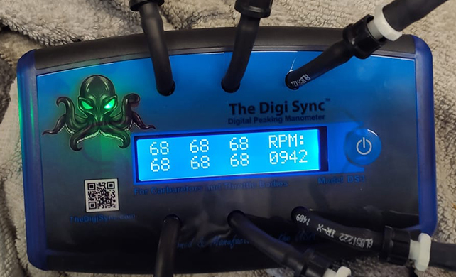

« Reply #11 on: October 23, 2022, 04:13:55 AM »
Just goes to show just how much a difference changing the airflow into the airbox can make to the running of the engine
Thought I had it all running well with the tank off, as soon as I replaced the tank, 1, 3 and 5 started to play up and missing which required all pilot screws to be taken out by a further half turn, this now matches the pilot screw settings i wrote down before I took the carbs off for a good clean.
Going to check today all 6 cylinders with a gunson colortune to see how far out I am, will then have to do another Carb Sync if I need to make any changes to the pilot screws.
So far the new digisync appears to be worth the money in getting the carbs in balance, makes setting up much easier, the results achieved can be seen below.
It's nice to get it all running so smoothly now, but i know once i put the Cobra's back on I'll have to do it all again . . . . Oh Well it's all a learning curve !!!!
