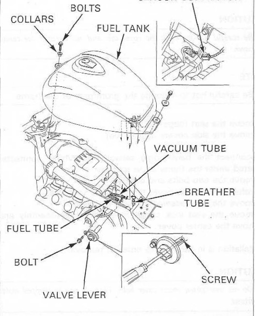

My project bike did not have a fuel selector knob or plate. The PO just had a piece of PVC tube pressed over the square fitting an the petcock. I found the missing parts on e-bay.
How does it bolt to the bike?
Also, I installed a petcock kit and found there was no filter over the brass tube of the petcock.
Where can I get that filter?
Thanks

you'll need a 6 x 28 flange bolt. I forget whether the bolt screws into a threaded boss or a nut is required.

Thanks guys. you were right. The filter was stuck in the tank.
The diagrams don't show where the petcock knob plate is mounted. I'm assuming it is the middle bolt on the rear of the motor mount, between the motor mount and the coil bracket. I should be able to figure it out once I get the tank back on. But first, 4 of the 6 carberators are leaking fuel, so next step is to pull carbs.

« Reply #5 on: October 16, 2022, 10:57:12 AM »
https://postimg.cc/gallery/qCCTKrG

« Reply #6 on: October 16, 2022, 12:31:43 PM »
Appears you have the bolt.
