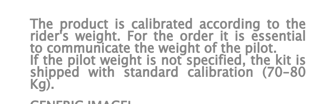

Most of the Italian sellers of the Bitubo shocks do ask the relevant question. My seller doesn't.
Here is an example of a Seller who knows what he's doing.....
It's my guess that the guy I bought from (It's a big company, BTW, with thousands of sales and a very high percentage Feedback) didn't read my accompanying message and just sent me the Standard shocks.
