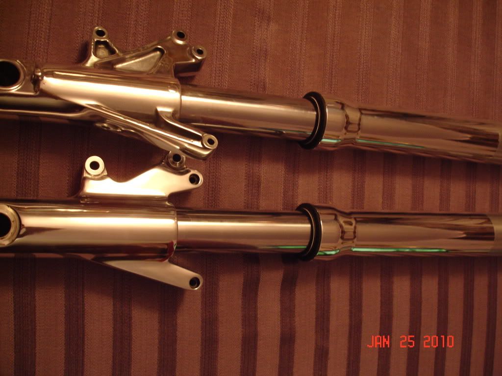

Very nice.  Any tricks or just loads of hard work with fine paper and polishing mops?

Nice outcome....how many hours did you put into them?  Dave

Procedure?

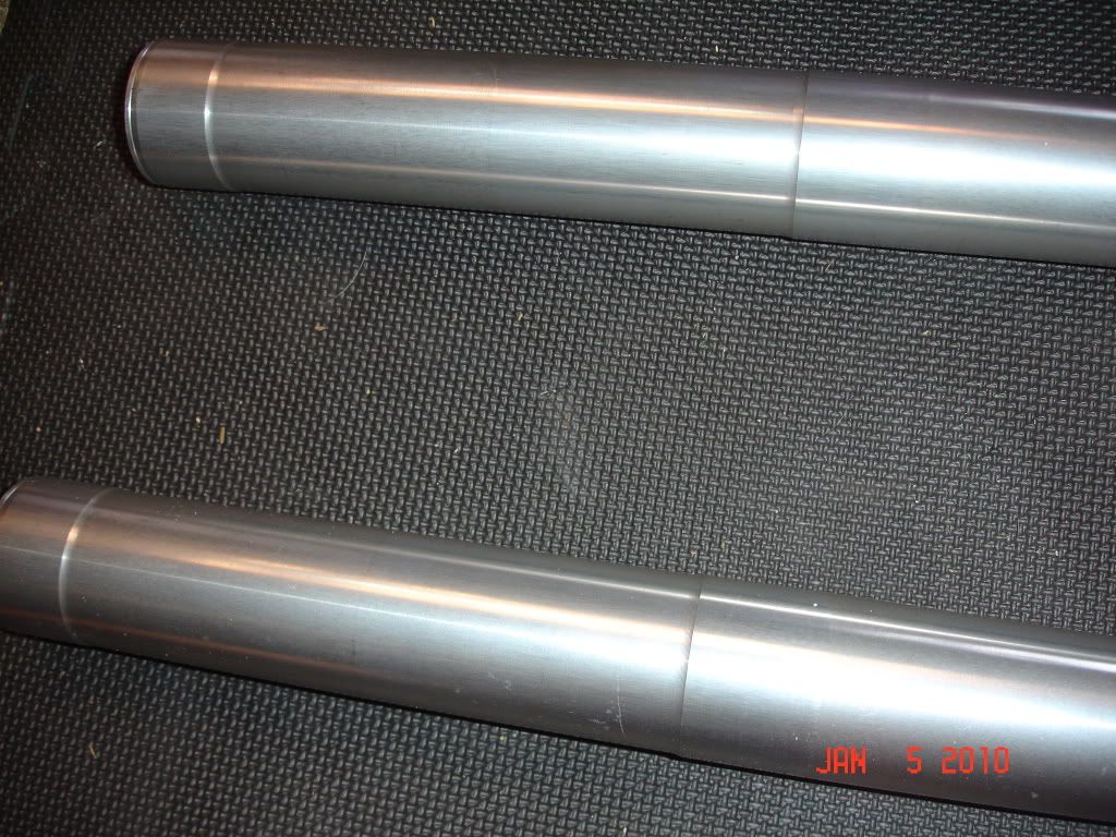

I did tons of reading first but since I was dealing with Daryl on ordering my raked trees, I decided to take his advice on polishing the forks which was less time consuming compared to many others. I bought a small orbital hand sander ($25) and a bench mounted buffing wheel ($40) which were the biggest expenses at Harbor Freight. A lot of people start with say 200 grit paper and go up in increments of 200 all the way to 1000 or even 2000 grit and then start using Tripoli and polishing sticks. Daryls suggestions were this which I followed exactly.
Fork Lowers: Acetone or Oven Cleaner to remove clear coat Orbital Hand sander with 320 grit wet sand paper Buffing wheel with Tripoli Buffing wheel with White Polishing Compound
Uppers: Acetone or Oven Cleaner to remove clear coat Orbital Hand sander with 320 grit wet sand paper Orbital Hand sander with 400 grit wet sand paper Buffing wheel with Tripoli Buffing wheel with White Polishing Compound
I have to say the lowers were much more time consuming than the uppers. I did a good amount of the sanding of the lowers by hand because of all the small curves. I also used a dremel in the small places to polish them. When sanding the uppers, he suggests to not polish the areas where the trees mount as there is no need to make that area smooth or slippery. I dont know how many hours I spent but it wasnt as bad as I thought it would be. Once I got the lowers done, the rest went fairly quick. When removing the clear coat I used the Acetone on the lowers and then tried the Oven cleaner for the uppers. I did my best to get most of the clear off but since I was going to be sanding the hell out of the forks, that was going to take off most of it anyway. On the uppers, make sure you sand away all the ribbed tool marks to get the smooth finish. Once I did the bulk of the sanding on the lowers, I would just sit and watch TV hand sanding all the small areas. For the Uppers, I hand sanded the areas where the line was for where the treees mount first and then went to town with the orbital. Good luck. Its worth the time spent. If not for Daryls help, I would still be working on them.

Before you install them, take them to a powdercoater. Get them clear powdercoated. Never have to polish again.
They have clear coat for powder coating? Didn't know that, was just going to us a spray bomb and clear coat it myself. I think the powder coat would be better in the long run, and worth the extra cost.

Hey Steelers... Those look beautiful  Did you need to disassemble the forks, or did you leave them, and work on each one as a whole assembly? Black Dog

Hey Steelers... Those look beautiful  Did you need to disassemble the forks, or did you leave them, and work on each one as a whole assembly? Black Dog Looks great ...Well done

Hey Steelers... Those look beautiful  Did you need to disassemble the forks, or did you leave them, and work on each one as a whole assembly? Black Dog I did not disassemble the forks though if you did it may be easier to work on the lowers. Wasnt too bad though.

Hey Steelers, did you do the lowers with the tubes on or did you take them apart? Now I am convinced I have to do them also although I already bought some of the Hondaline chrome "Lower Fork Covers" because I didn't think you get them that nice. Daryl is having a good month, my 6 degree trees are due this week. Just got done polishing my tubes also. I had the good fortune of a metal lathe at my disposal so I started with 280 which took off the clear coat and the lathe grooves pretty fast. Then switched to 400 to 600 to 1000 and finished with a spiral sewn wheel in my 6" hand grinder and red compound while still on the lathe. I bought a complete polishing kit from http://www.caswellplating.com/buffs/gbkit.html . Now I am starting on the wheels.

Your uppers look great. My tubes were all together. I did not take anything apart. Lowers are just more time consuming. I did alot of hand sanding to get most of the areas a pretty smooth finish. Let me know how your install goes also.

I had my triple trees chromed and my forks polished. I had them clear coated and 3 years later the clear is dulling and they are chipped. Clear powder coat is the way to go but you have to take the forks apart. I have 2 other bikes with polished forks with no coating and I have to polish them at least twice a year.......

I have found the best thing to use is jewelers roug. At most truck stops you will find tank and wheel polishers who will be glad to sell you a bottle of their home made magic polish, this usually works the best
