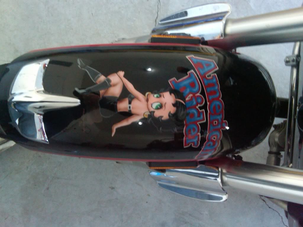

There is a huge Betty Boop  with "American Rider" painted on the the front fender of the bike I just bought. Do you think it could be buffed out or I will just need to get the front fender repainted?

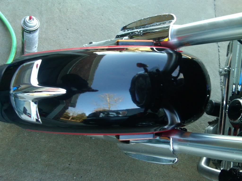

Well, it didn't have any clear coat, so I gave it a shot. I tried some oven stuff, but I went to some brake cleaner on a rag. It wasn't too bad. I used some color restorer/wax when I got done.
Thanks for the tips guys.

« Reply #12 on: January 27, 2010, 07:53:50 PM »
Looks great in the picture. Is this color restorer something you'd use regularly or is it hard on the clear?
