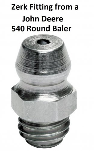

People talk of getting a fitting that allows to hook your grease gun
to the caliper and pumping the pistons out with grease...

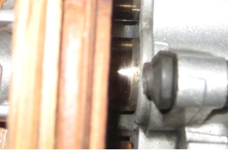

When I remove mine to do work on them, I usually pull the caliper then use the brake lever or pedal to compress the pistons onto the pads without the disk or onto a piece of wood to get them most of the way out.

I have used the grease gun method. Works good but a mess to clean up unless you have a parts washer.

 S O M E T I M E S  pushing them back in a little will loosen them up, then air or hydraulic pressure to get them out.
  When I was working at the bike shop , we had a customer come in with an old set of calipers frozen for several years. Claims they tried every trick known. I used the grease gun method and had them out in about 15 minutes.
 On dual pistons , block the one that pushes out first. I use a piece of 1/4 inch plywood.

I used a couple of one-bys  to let the air blow my pistons
out together in stages... after they came out this far, I removed one
of the one-bys...
