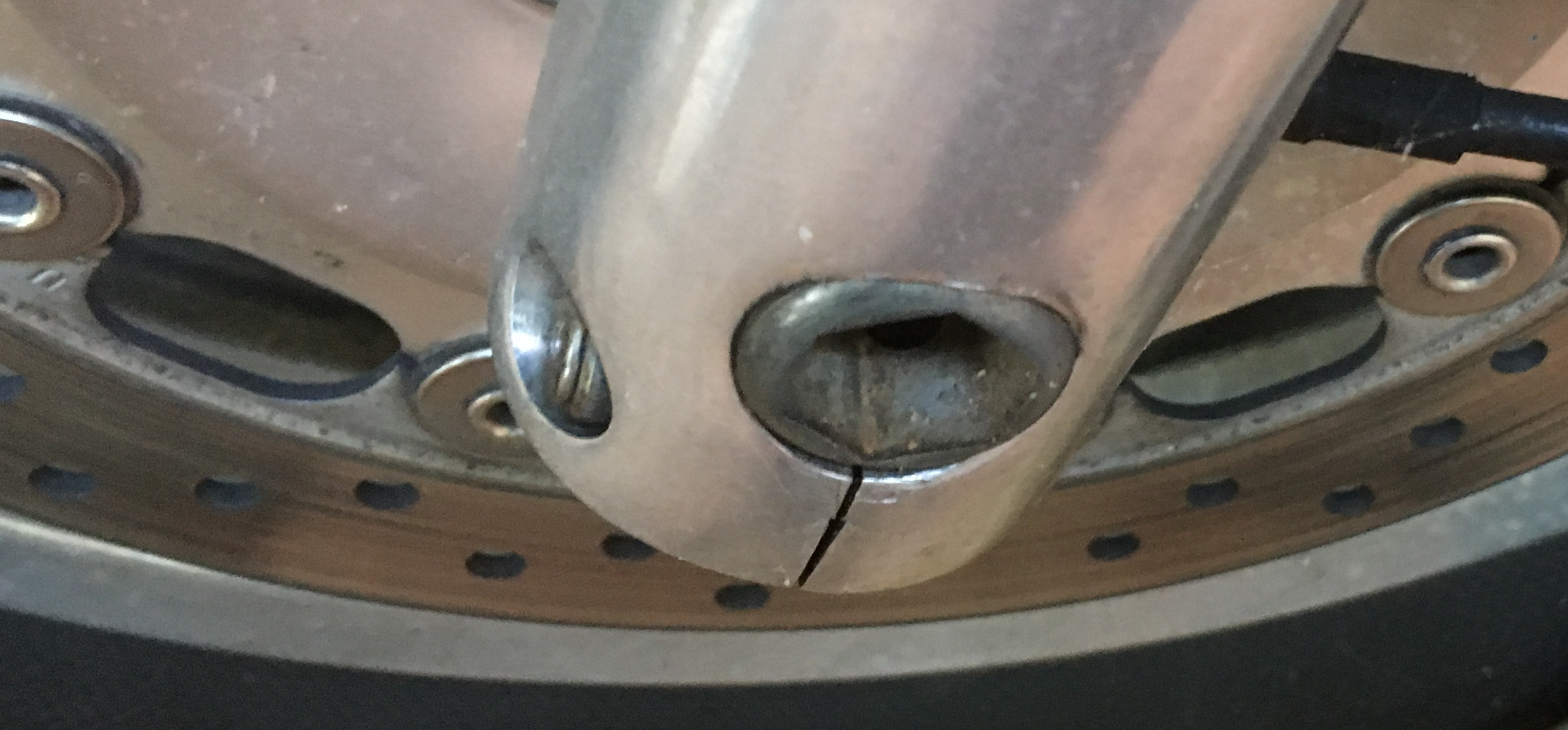

« Reply #2 on: February 24, 2023, 11:04:49 AM »
When it is properly seated, the axle will be flush like this:
When it is not seated right it clicks on stuff as it goes around...
