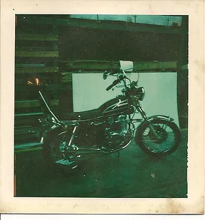

I remember when a bike had to have a sissy bar!
