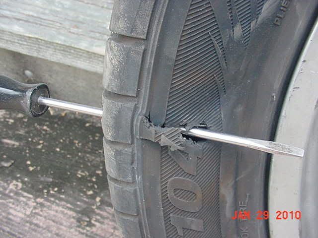

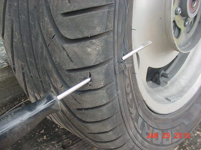

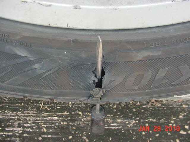

Here's a few pictures of what happened day before yesterday coming home on Interstate 77 from the VA.
I was cruising at 75 to 80 miles per hour.
I ran over something really bad and the tire went immediately flat.
Why I say this is a testament:
I've had a rear motorcycle tire go out in the past (just the same instant decompression) and the motorcycle took me on a whoop-dee-doo where I crossed over three lanes of interstate traffic out of control and finally got the bike stopped. I was extremely fortunate to have survived that little exercise  that happened on I-95 in Connecticut.
Now let me tell you about this time.
The bike was very easy to control and there was very little oscillation. I was able to bring the bike to a point where I could get off on the shoulder without any traffic running over me. I felt the tire go flat and a little side to side wobble but absolutely easy to control.
The reason this was a good outcome was due to the wide flat tread on the tire combined with the shorter sidewall height as opposed to a motorcycle tire.  The tire simply collapsed and settled down on the wheel, something you will never find happening with a motorcycle tire experiencing the same type of decompression.
This car tire may have save my life.
Needless to say I'm going back with another car tire. Ordered it already, actually that same Wednesday night!

The sidewall looks to be in pretty good shape, considering.  Impressive!  Glad you're OK, and the Fat Lady, too!

John, I do not believe he ran over the screwdriver and it was the culprit.
 If you read the post he ran over something. The screwdriver was placed in the damage
to show entry/exit area. At 75-80 miles per hour the screwdriver would not stay in
the tire. Much less not contact the swing arm. I trust you knew that and your
answer to the post was a bit of sarcasm.  As sargent Joe Friday would say
just the facts man.

Looks like a bullet hole to me....who was he running from?

10-4 on that Larry. Like any wise crack, it doesn't bear close scrutiny or explanation. A screwdriver would have made a much neater puncture.
In any case it sure is ugly.

To finish this up:
I received the Falken tire (Ziex ze-502  $87)same size as the other 205-55-16, mounted and balanced it.
The Hankook which I failed to mention, stayed true on the rim and since I was only about eight or so miles from home, I did end up riding home on the flat tire (staying on the road shoulder) at a nice slow speed. It was a slow going ride and I was kinda thinking it was like those ride flat tires like they use in the race cars. Yeah, what a laugh!
The tire (Hankook) showed very little damage to the inside from riding it flat, maybe some slight abrasion and polishing on the inside from the beads and sidewall rubbing on the flat tire. The wheel itself never touched the pavement, it was like riding inside the wide tread, kinda like captured almost, between the upturned part of the tread.
The only part I am upset about now is the fact that the Falken tire came with two painted dots on the sidewall, each about 180 degrees apart. One was yellow and one was red.  I installed the tire on the wheel with the yellow dot at the place of the valve stem. How was I to know it should have been the red dot instead on the yellow aligning with the valve stem.  I tested the balance before seating the beads but I just couldn't get the tire to rotate on the wheel as hard as I could try. I used liquid soap and muscle but I couldn't get it to budge. I wasn't going to un-mount the tire so I could rotate the darn thing, that was just too hard to do to begin with.  The result was a lot more weight than I like, to get the thing balanced.  If I have to remove the wheel in the future I may take it and get it rotated, just don't know!
