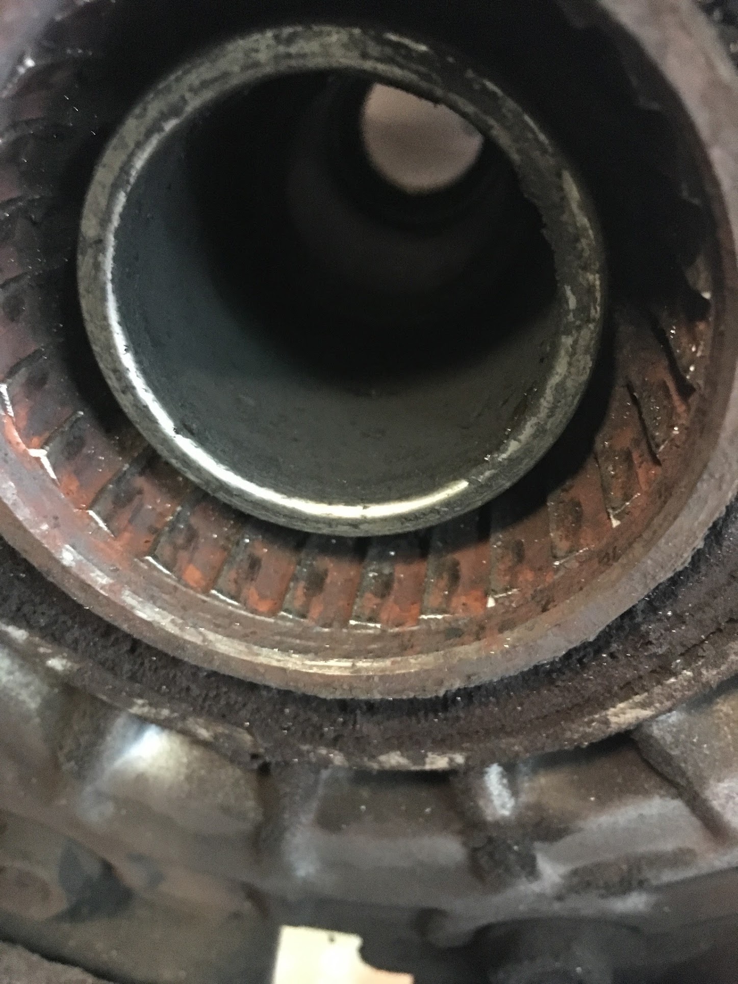

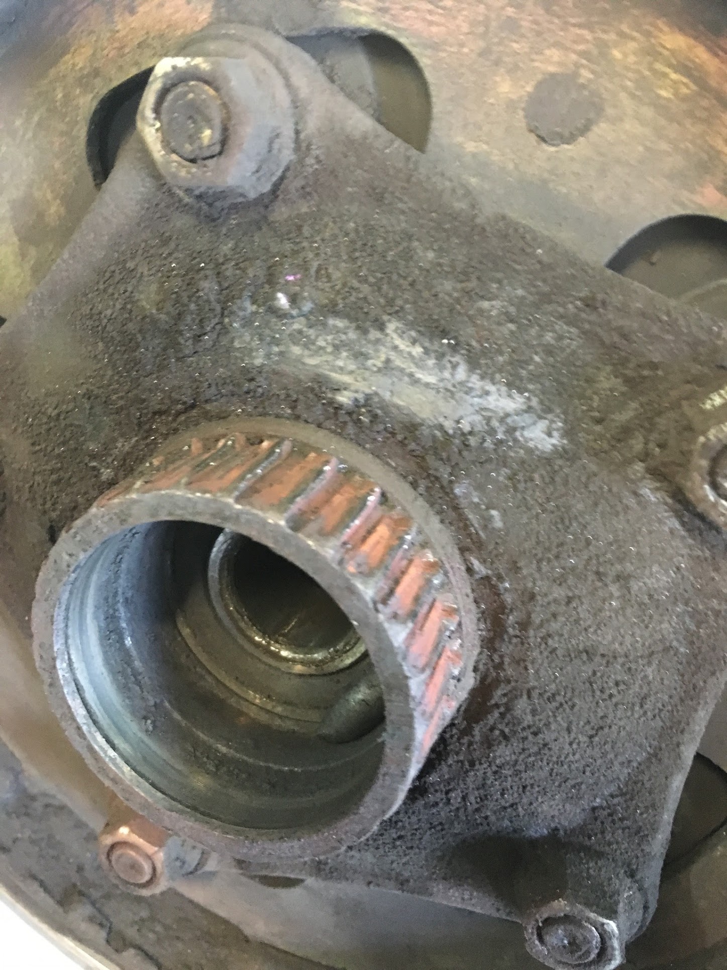

After you sort out the fueling issues (carbs + gas tank), you should spend quality time to inspect the final drive.
Most shops (including Honda shops) don't do the proper maintenance while changing tires (i.e. new o-rings, moly grease, proper alignment of the pumpkin, etc) and that combined with the massive torque generated by the flat six engine will destroy the splines.
Look what happened to my I/S in 2016:
CamTom12
Posts: 133
VA
« Reply #34 on: July 08, 2023, 04:06:53 PM »
ick ick
I’m sorry for your loss, man.
