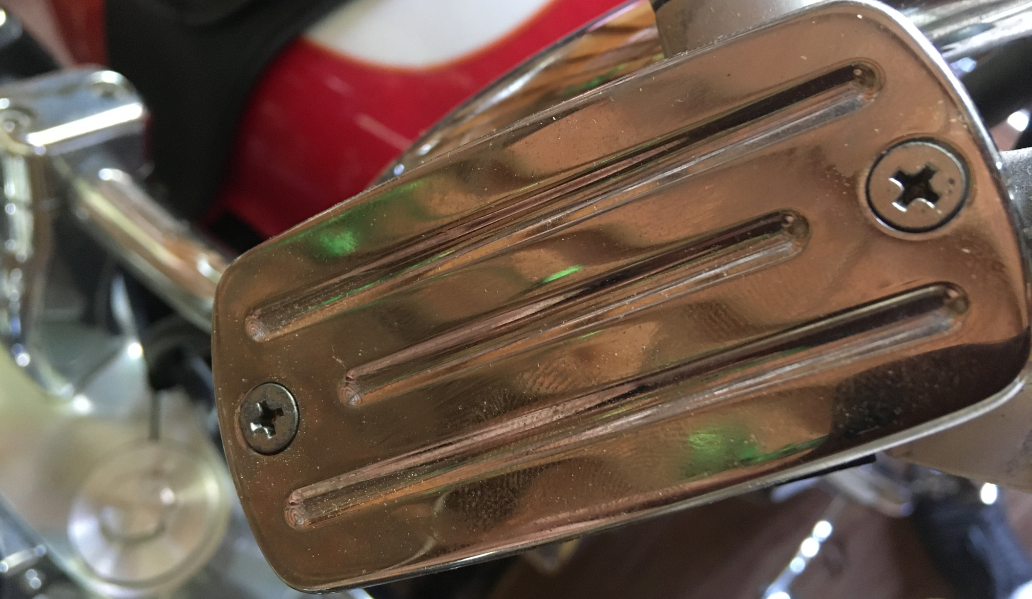

A breaker bar should be used to remove bolts instead of a ratchet. It doesn't have to be an expensive breaker bar either.
The Valk screws are JIS and a JIS screwdriver should be used on them. The good news is a JIS screwdriver will work on phillip head screws so it's not a specialty tool that's gonna just sit in the toolbox. The bad news is the price of JIS screwdrivers have gone way up. Even JIS screw bits are expensive. I bought a 4 screwdriver JIS set for $18.99 in 2018.
Profile B on a JIS screwdriver tip is flat. Profile A on a phillips screwdriver tip is rounded and will slip and round out a JIS screw head.
A dimple designates a JIS screw although not all JIS screws are dimpled.
The Valk's fork caps have either a locknut or hex nut under it. Regular open ended wrenches are too thick to fit under the fork cap, but the economy wrench in the tool kit is thin enough to slip in there.
Clear plastic tubing holds the battery nut in place. *Via Shane Conley who has been posting youtube videos for 11 years, and a motorbike repair instructor at a vocational school.
A solid core copper wire bent into a hairpin also holds the battery nut in place. That said, some days it works less than other days.
Anyways, the hairpin shape provides clearance for the battery bolt. (Note: the length of the copper wire is exaggerated.)

Thanks. Yes, people forget the importance of the jis screw driver. Makes a big difference.

Vessel brand on Amazon is what I have and yes I hardly ever use my Snap On variants anymore. I have a custom made 1/2" drive T shaped bar I used in disassembling molds that the bar slips to any position needed and has 6" long of reach for deep c'bore in the molds. Bent the 3/4" drill rod handle a couple times but I made the head out of air hardened H13. I got a 3/4" drive variant I purchased for the tractor lug nuts but doesn't have the reach and has shorter handle. I really like my Ryobi cordless 1/4" impact which I use constantly.

In my experience, every el-cheapo auto-parts-store
tray-of-whacky-bits-and-a-handle includes a perfect jis bit.
A regular phillips will eat reservoir screws alive...

"There are the real JIS and the not-so-real JIS screwdrivers. Remember, JIS is a standard, so a screwdriver needs to be made to that exact standard to be considered authentically JIS.
Most JIS advertised screwdrivers sold today by companies like Vessel, Hozan, and others are actually conforming to a new standard: DIN 5260 which is identical (at the tip) to the newer ISO 8764-1."
"The reason these companies have changed to DIN 5260/ISO 8764-1 is because the new standard is designed to work in both Phillips and JIS screws.
To date, I have only been able to find one confirmed manufacturer that still uses and builds to JIS B 4633, and that is SUNFLAG otherwise known as New Turtle in Japan:"
https://rtstools.com/jis-vs-phillips-screwdrivers-and-where-to-buy-a-jis-screwdriver/
The latest Harbor Freight phillips are to the new DIN standard and work very well with JIS screws.

Not to take anything away from this thread… I’ve changed my reservoir screws to stainless steel flat head Allens. No more bungled screws there!
That's good news. Of course most people own so many screwdrivers already they're not likely to buy the new phillips (DIN 5260/ISO 8764-1). How would you know for sure it's the new phillips though? JIS preceded phillips by 20-years although the unknown inventer didn't receive a dime like Phillips.

   I never had a problem using my '70s vintage and newer Snap-on screwdrivers, and many other much newer phillips heads.
  You just gotta push hard while breaking the screw loose.   And not be afraid to touch up a rounded-off tip a little on the belt sander...

But just to provide a little background to the above discussion, here is what a phillips head driver looks like-   the 1934 patent drawing for Phillips head drivers...  ( if I can only get the image to show up)
