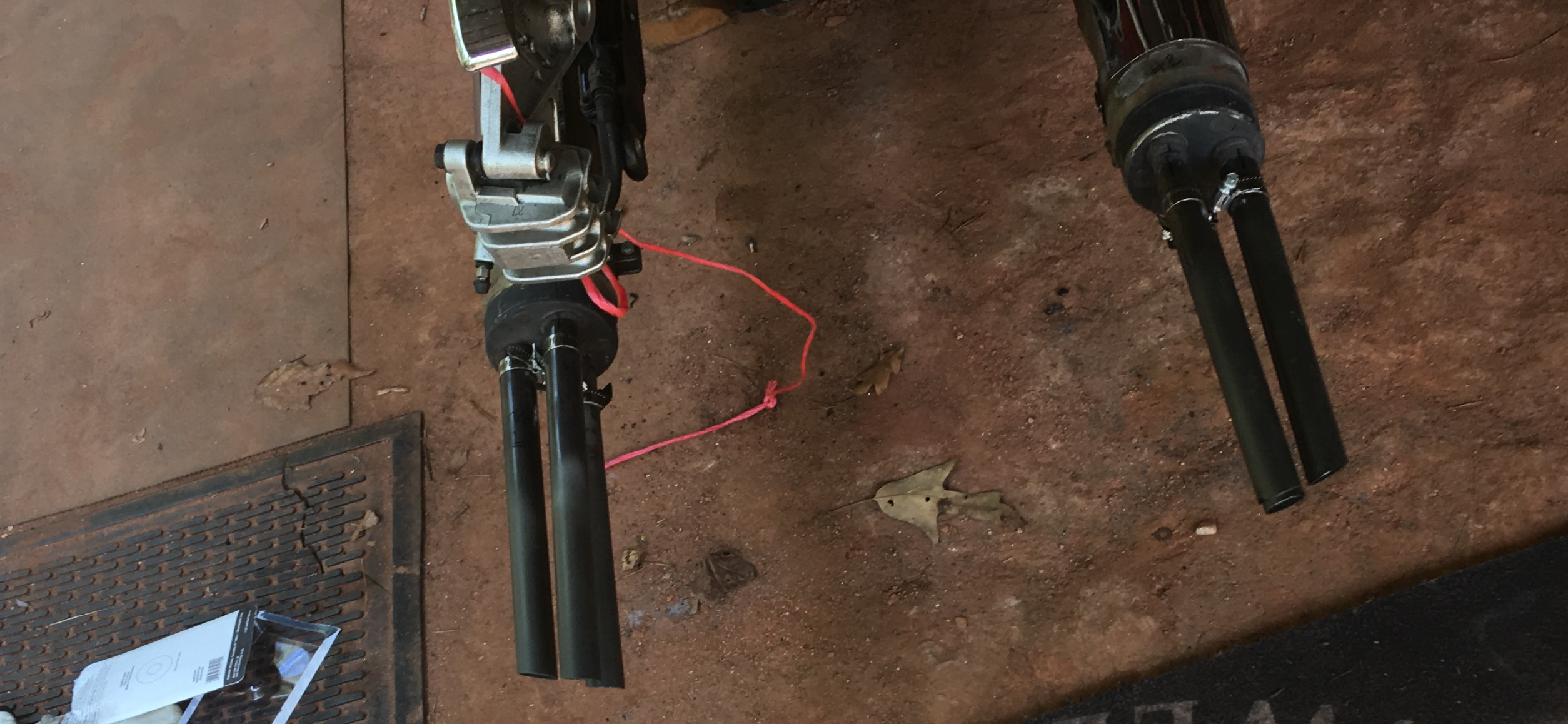

I have one with cut (trimmed not completely removed) piggies (and truck stacks), the other bone stock (except truck stacks too).
I'd estimate a 15 to 20+% increase in noise.  It's a rumble, throaty noise.  It's not that much at idle, but gets louder with speed and RPMs (which is true for all exhaust).
I now wear earplugs to ride because of constant tinnitus (and for hearing protection); not so much for exhaust but for wind roar (half helmets).
I used to prefer the cut piggies, now I prefer the stock.
One piggie is threaded for OE tip mount.  It would be nice if that threaded boss is intact.

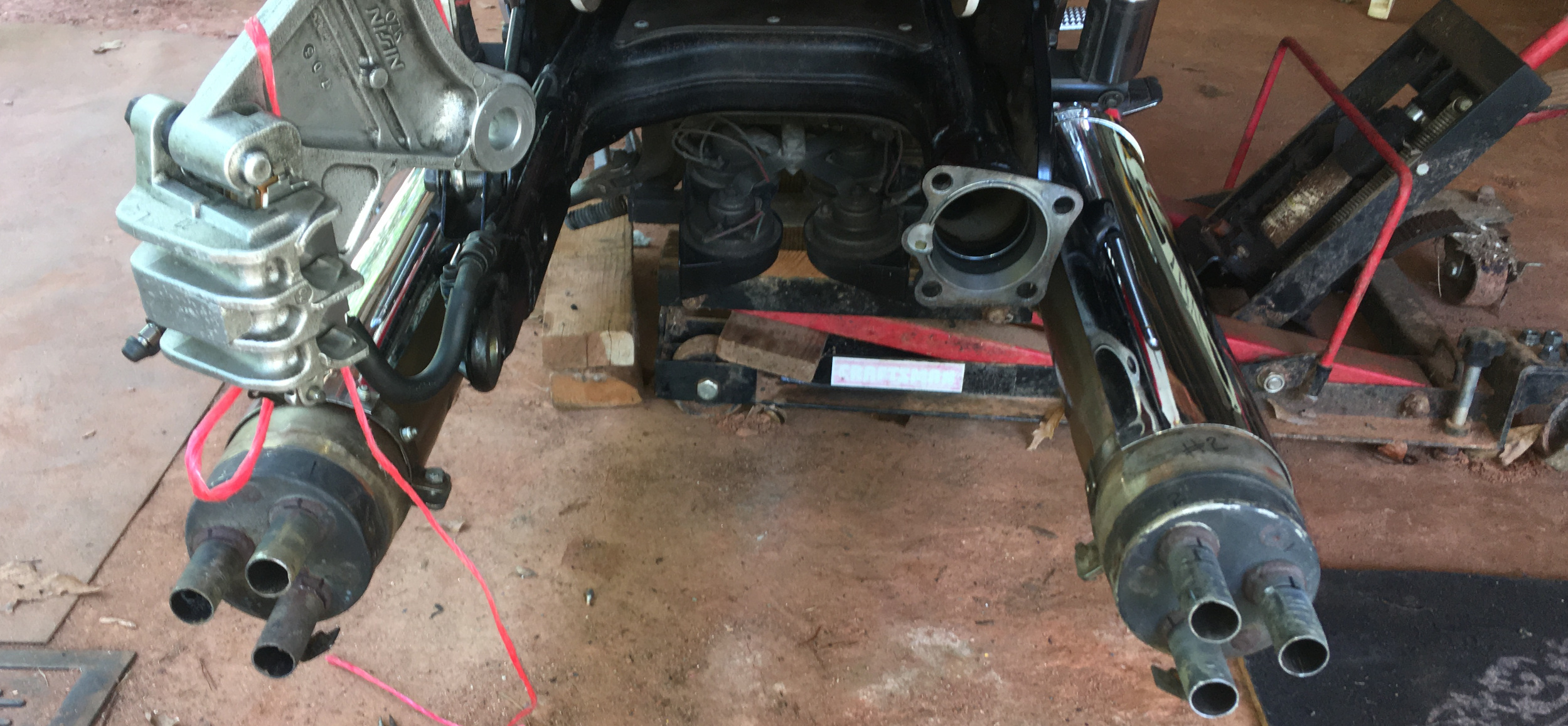

I took my standard exhaust off as I'd bought another one, used and in very condition, with the sole purpose of cutting the piggies off. I didn't want to remove them from my existing exhaust as obviously you can't undo what you've cut off.
I removed the piggies leaving around 3/4" on each one.
I like the more throatier burble it makes. It's not as pronounced as I thought it was going to be but that's not a bad thing. On other bikes I've had, aftermarket exhausts get on your nerves after a while.
The difference is noticeable but it's still subtle. This set up will be staying as I'm very pleased with it.
Should I ever sell the bike ( not likely) I'll put the standard exhaust back on and sell the "piggy-less" one.

I cut each one a different length (leaving enough to add back if wanted) on my tourer. I did different lengths to try not to get an annoying drone at highway speeds. It’s definitely a little louder and deeper than stock, and I don’t notice a drone. I want to do the truck stacks eventually but enjoying it as is now.

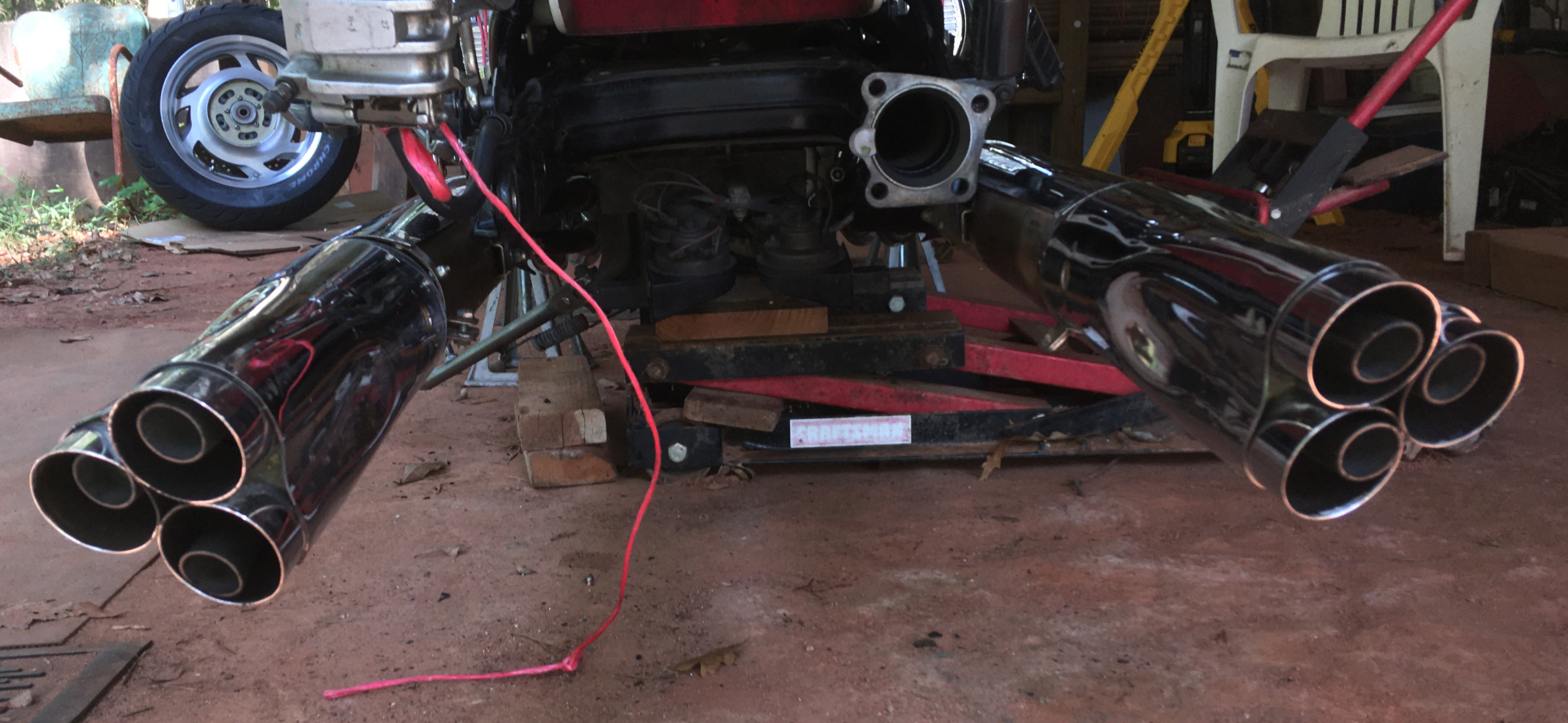

« Reply #7 on: August 02, 2023, 08:09:01 AM »
I cut my piggies, extended them straight and they line up perfectly
with triple tips  cooldude ...
I think getting the piggies to the end of the tips is quieter than any of the alternatives
where the piggies end inside the tip/echo-chamber.
