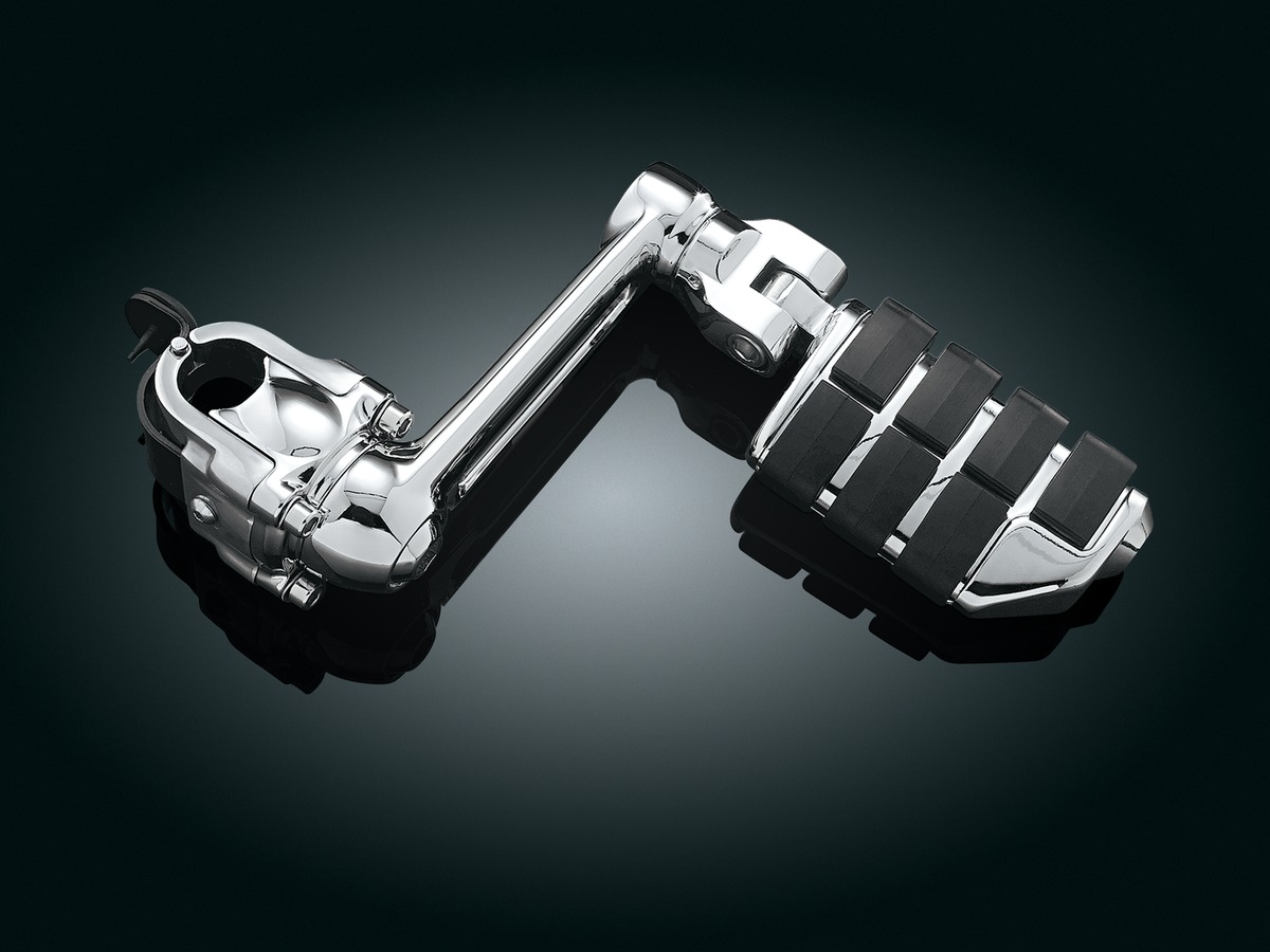

I've received the pegs today from Purdys Powersports.
I'm not wonderfully enamoured with the fitting instructions....

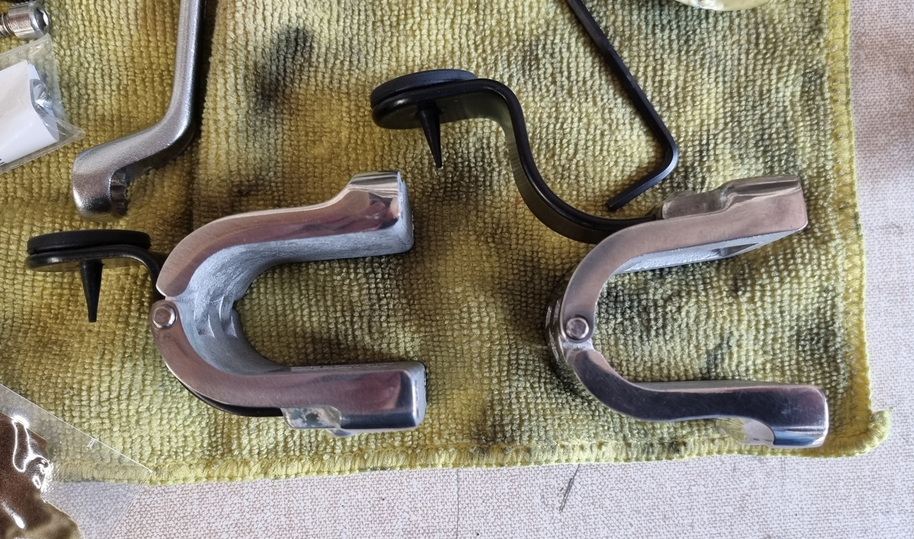

There are two pics showing the "hinged clamp/levelling brace orientation " for a gl1500 and a Valkyrie.  I thought our bikes were both of these.
So which do I choose please and what are those black bendy bits for? What do they do?
Dies anyone have a pic of them on the bike, possibly to help please?
Thank you..

The GL1500 they mention is the Goldwing, it has different crash bars than a Valkyrie.
When mounted on the lower bar, the black bendy piece with the bumper rests against the valve cover to keep the peg from rotating down.

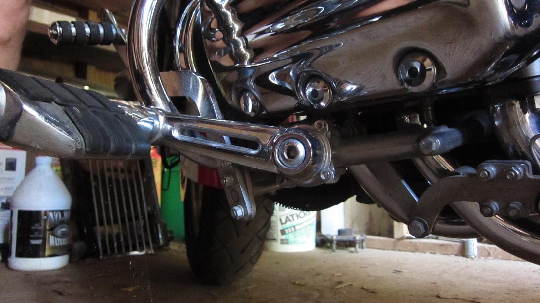

I put mine on the curve... I bet it left a mark... it is where I like it  cooldude ...
Posts: 16793
« Reply #5 on: August 07, 2023, 03:46:04 PM »
I mount mine off the engine guard, not below the guard.  I do mount them with clamps that wrap all the way around.  The picture in the original post does not look like a wrap around.

« Reply #6 on: August 07, 2023, 03:57:10 PM »
Carl, the pictures show bosses (screw holes) in the end of the U's; The rest of the clamp and offsets (not pictured) bolts to them for wraparound.
