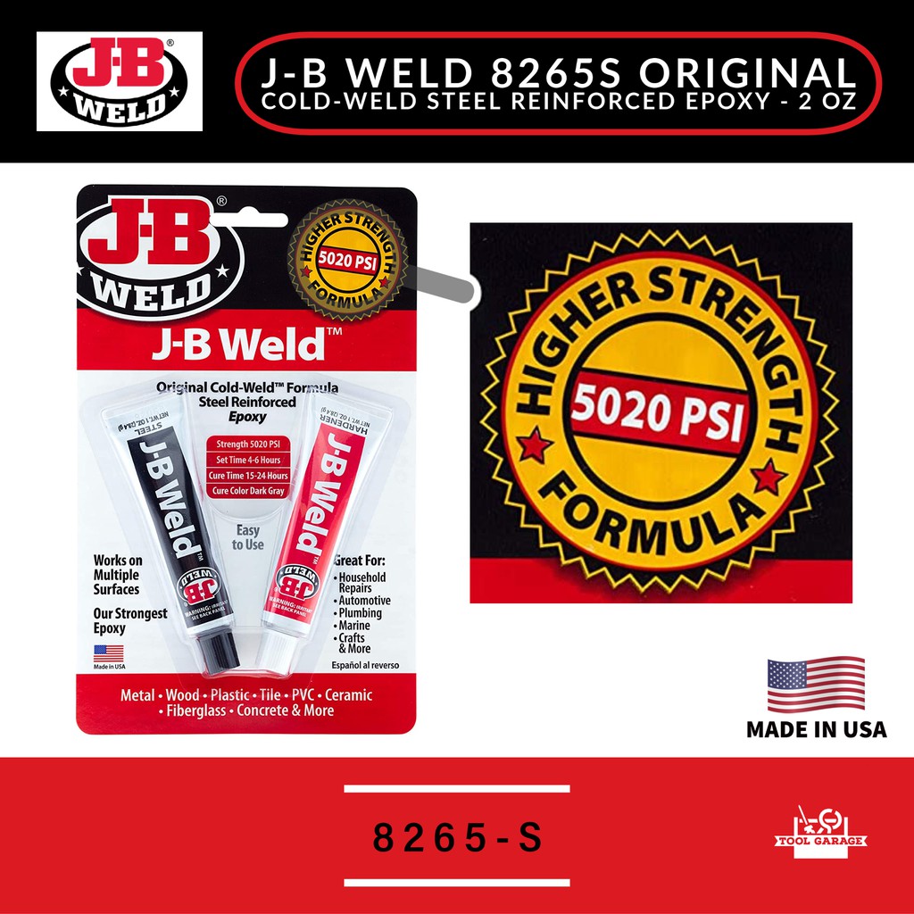

Thinking I may be on to something here,  but I gotta wait a day to test my theory.   The Bullet is a desmogged Cali model.  The desmogger had plugged some carb tubes with a (gasket?) sealant, and when I was doing the carb springs the other day I noticed some minor leakage around the old sealant.  Even poked one big glob with a screwdriver to make sure it felt solid and thought it did. Sure enough, when I got back in there and poked it with a screwdriver again today, it popped right off.  The center one didn't take much effort and also popped off.   Found the last little bit of J.B. Weld I had lying around and mixed a batch up.   It's difficult to get back there but I used a flat screwdriver and globbed some on the ends hopefully sealing the holes up.  It may even take a second covering tomorrow for peace of mind.
J.B. Weld is our friend.  Off to buy more so I can do the other side.
Will try to remember to post if this did the trick.
Thanks for the replies.
« Last Edit: August 30, 2023, 11:45:52 AM by Valkorado » Logged
Posts: 10517
« Reply #11 on: August 31, 2023, 03:17:44 PM »
Whoo-hoo!  That was the culprit.  The bike is running much snappier as well, and it has always been fast.  Smoother in the middle too.  It could be that those old glob plugs may have had more air leaks than I was aware of, or that the Interstate springs are actually giving my old Tourer a bit of a boost, or a combination of both.  Anyway, I bought more J.B. Weld today (they have a new "improved" original formula --  5030 psi strength instead of the old 3960 psi original blend).  Same 550°f heat resistance.
