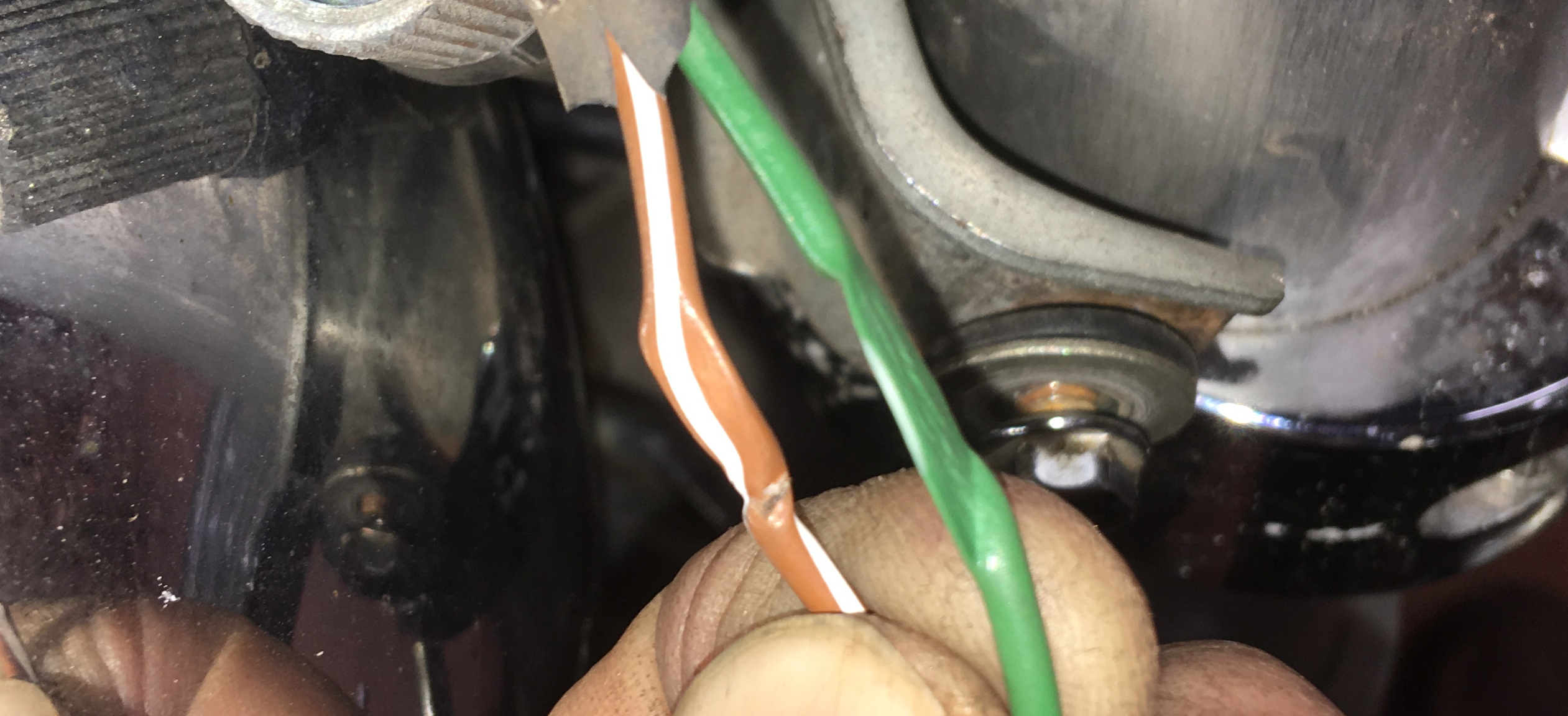

Posts: 16804
« Reply #5 on: September 02, 2023, 05:51:43 AM »
There's a green-wire circuit associated with those things.
Once I mooshed one of the green wires in the windshield bracket
and after a while the wire cover wore through  and I got pretty
much your symptoms...
You'll probably have to run that green wire from one end of your
bike the other to find the bad place, if that is what is wrong...
In fact, now that I look at my picture I see that as I was running
the green wire, I found both it and this brown/white-stripe wire
were mashed in the  windshield bracket...
