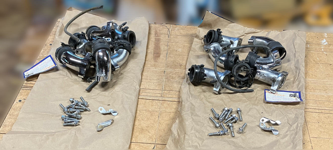

I just received two sets of intake runners from Pinwall, $13 for each set:
Now I have some more useless intake runners, some good bolts
and four bits of unobtainium. It is ambiguous whether that stain is
dirt or surface rust, but Nevr-Dull will make it shiny enough to
go on Smokin' Joes bikes...

Those thingies are worth $5 a piece, easy. For some reason they're never sold with the used air tubes.

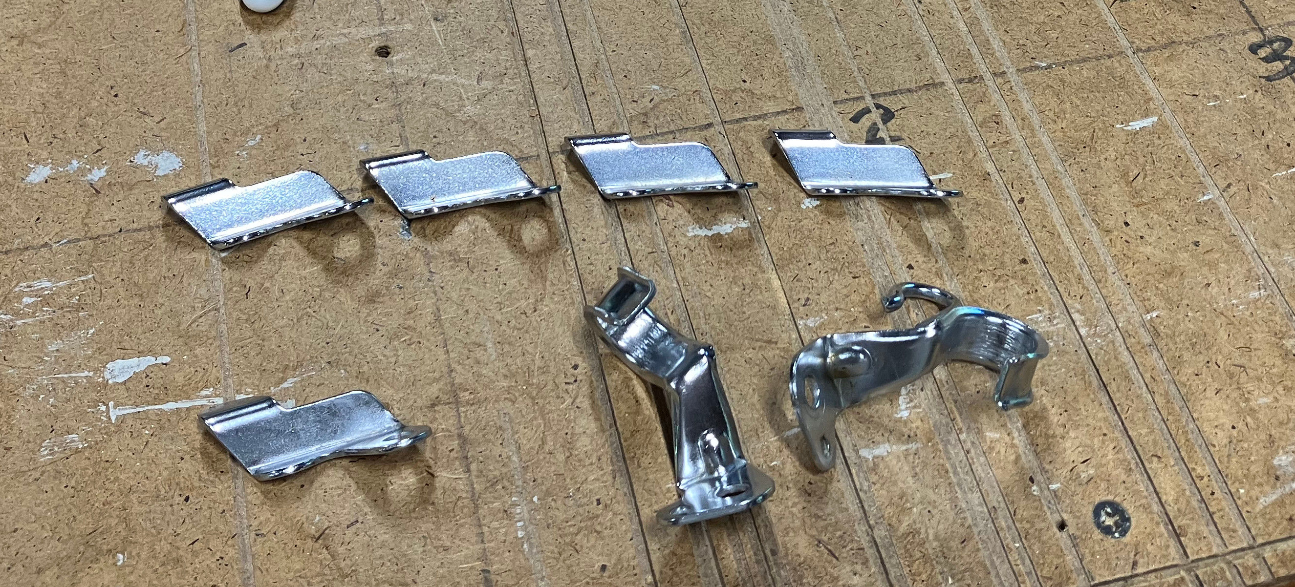

I found some hold downs (stays) available but they're a dime a piece. About the only other oem parts website that still sells them, MotoSPORT, quotes them at $14.64.

I still don't understand how the hold downs (stays) got sold out on almost every oem parts websites. Who buys them except for desmog? It's not a part that gets damaged.
Even if the factory produced a limited supply, at $10 a piece they ain't gonna sell. Maybe it was priced at $2 then some other bike brand owners ransacked the inventory
to use it for whatever. Now that the part is few, the vendors jacked up the price. Seriously, I can't imagine this little part being sold for $10 way back.
When you desmog you lose two hold downs since they're tack welded to the air injection tubes and the air injection tubes are eliminated. But the hold downs
still can be used by grinding off the air injection tubes at the weld. The weld is on the under side where grind marks will be hidden. There's two welded hold downs.
The two other hold downs on the engine are unwelded and to differentiate them apart they'll be referred hereonafter as the 'good hold downs.'
The good hold downs are bolted to the base of the intake runners. The bolts sit at a higher elevation than the top of the plugs (green colors)
so you'd need a step-down hold down in reference to the bolt.
Below, the step-down section.
A horizontal leg accomodates any horizontal offsets.
Since form is just as important as function, whittle away the parts of the blank that don't resemble a hold down and two months later you'd get B,
the preferred embodiment of the present invention.
The diy hold downs replace the hold downs that are welded to the air tubes. However on those, the plugs are higher than the bolts
so they require step-up hold downs in reference to the bolt.
Rotating a step-down hold down 180° makes it into a step-up hold down. Does it work since many upside down parts, mirror images, so forth, don't always align with the
part that they suppose to? Perhaps, test fit the good hold down in the new position. I would test them out but my hold downs are under tons of things in the locker room.

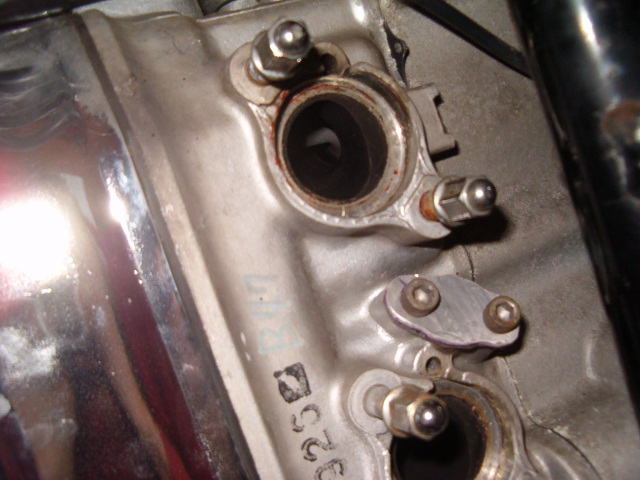

« Reply #17 on: September 20, 2023, 05:51:48 AM »
Well, I thought you desmogged so the air tube wouldn't be there. Redeye's stainless steel material probably more practical if the chrome there is a rust spot.
I desmogged using a recipe that used to be in shop-talk... now it
looks as if has been rewritten using some kind of "shiny desmog kit"
or something... anywho... I cut the chrome top plugs off the pipes,
filled the chrome top plugs with epoxy and turned them in so that
the plugged hole is hidden. The hold-downs are still needed in each
corner. I dremel-ed out a couple of bottom plates from some aluminum
from Lowes...
