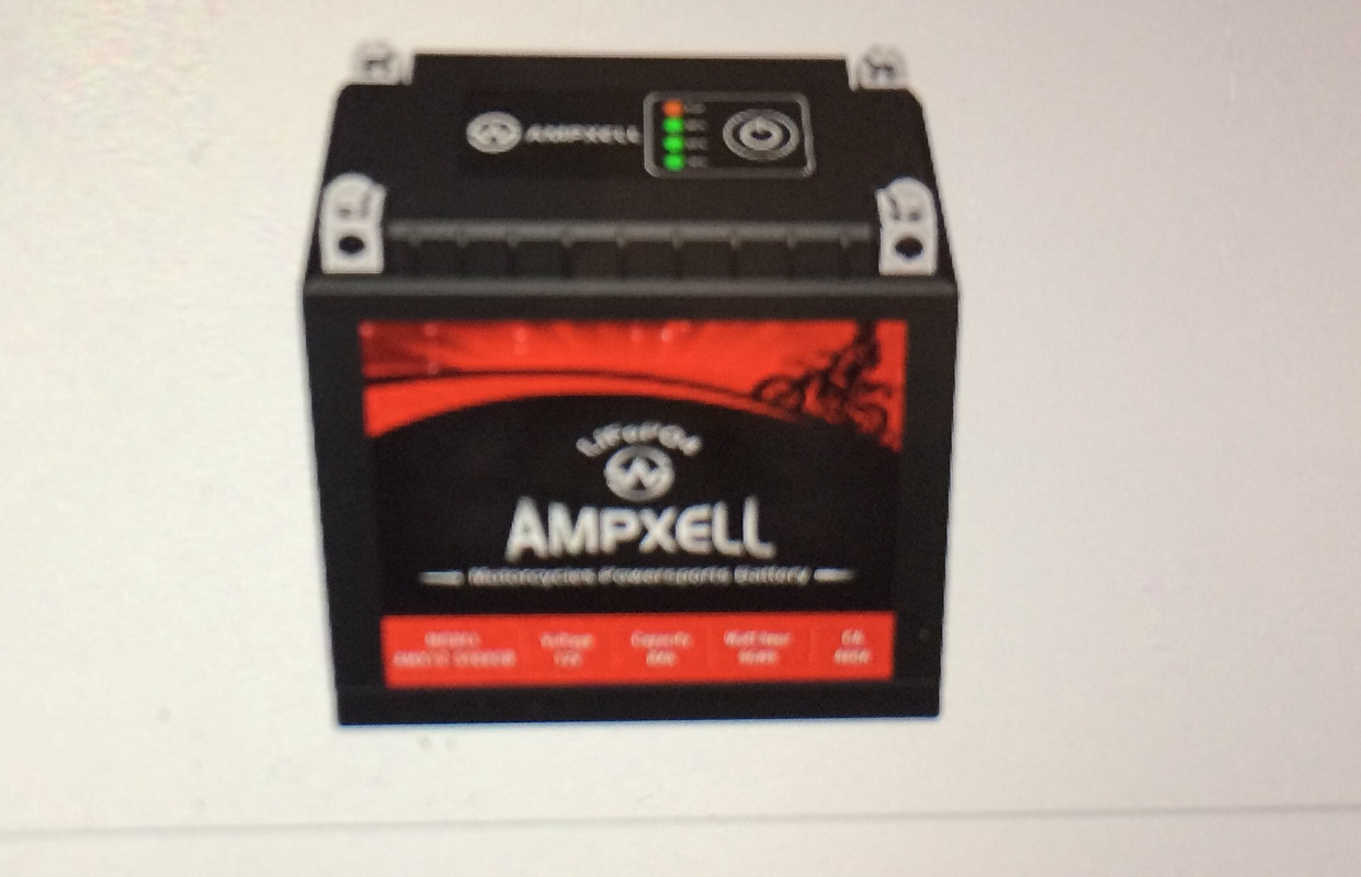

I went with a lithium and bought the charger at the same time. Bike sits more than ever due to caring for my wife. It has never been on the charger since the initial feeding.
 Bike spins fast and starts fine.

if you don't mind me asking how did you pick the lithium battery that you bought? There's many.
I chose the lithium currently in the Valk because Batteries Plus had an internet sale which made the battery only $10 more than the replacement AGM battery...
Been 14 months now and the bike cranks strong and starts easy even after long stretches of non-riding due to the extended heat wave we've been enjoying here in Central Texas.

Going byemory???? I believe it was $140.00.  Charger is different so I got a matched set.

I went with a lithium as well. And got a new charger too. A couple hundred bucks but I’m hoping the lithium battery lasts longer. We shall see. It’s been great for eight months or so now and it’s he charger is way better than my old one.
