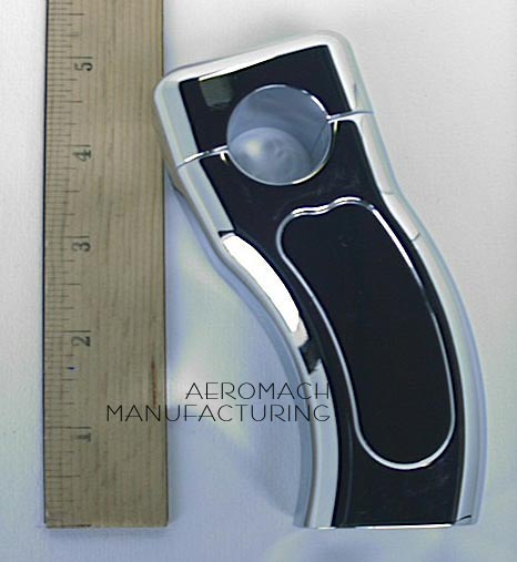

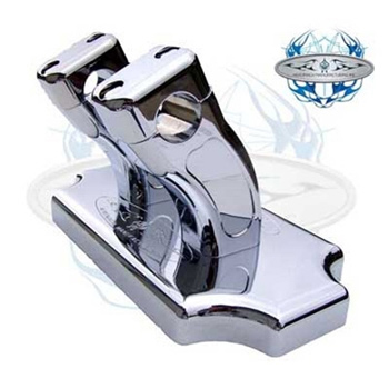

Those risers look a lot like my 4" "pullback risers" by Aeromach.
These are listed for Yami Road Star, but they look the same (one inch bars).  https://store.valueaccessories.net/4pullbackrisersforroadstar.aspx
Back in the day when Honda Direct Line catered to the Valkyrie trade, and even had a special section on their website just for Valkyries, HDL made their own knockoff version of the Aeromach risers.  Long gone.
Mine have never slipped.
