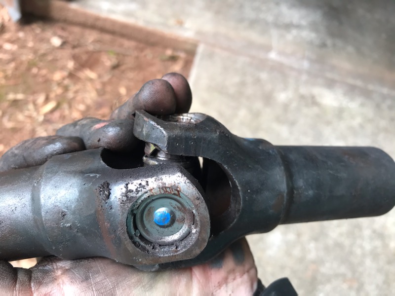

Had the same issue turned out to be the u joint
If you order one get the boot as well  ( unless you enjoy the words that come out of your mouth while you struggle to get the old boot back on

« Reply #14 on: September 20, 2023, 03:55:40 PM »
can you replace the u joint with boot on ?

« Reply #15 on: September 20, 2023, 04:40:16 PM »
I see what you mean. Is it possible to pull the driveshaft out through the swingarm with the u-joint stuck on the drive shaft??

The only "trick" I've ever pulled off is reusing the old boot - I rolled
it back on itself like in the video Lady Draco posted, afixed one end
of it and rolled it back into place.
There's people who say you can push the driveshaft back on its spring
and remove the u-joint without removing the driveline. That makes
my brain hurt.
I don't think the u-joint, even if it would stick on the end of the driveshaft,
would come out of the boot, or travel/fit down the swingarm. Many of us have
a hard time getting the driveshaft back onto the ujoint, I'd like to video
the guy looking down his swingarm trying to shove a driveshaft with a
ujoint on the end of it back down the hole and through the boot  onto
the output shaft :-) ...
Removing the final and the driveshaft for cleaning and greasing should
be an "every tire" kind of thing on a Valkyrie, Going to the additional
trouble to look at the ujoint seems warranted every now and then,
especially if you don't find something else to blame the vibration on...

You DO have to remove the wheel, final drive and driveshaft to access the U-Joint
You DO NOT have to remove the swing arm. However the u-joint will not slide down the tube of the swing arm. Not even close. It must be remove from the forward end of the swing arm. This necessitates unbolting/moving some stuff in that area like the brake oil reservoir and some hoses, but it can be done and sorry,  yes, the boot has to come off.
Posts: 8753
« Reply #19 on: September 21, 2023, 01:26:38 PM »
The u joint can be removed without removing the rear wheel.  The boot must come off.  It's not easy, but can be done.
Really, and you can reinstall it with the wheel/drive line in place? Please describe the procedure.
Posts: 8753
« Reply #21 on: September 24, 2023, 01:37:58 PM »
As close as I remember it:
Jack the bike up and remove the rear brake MC and Pedal and move out of the way.
Pull the boot back and use a long pry bar to slip the u-joint to the rear on the drive shaft while removing it from the trans output shaft, slip the front of the U-joint off the output shaft and remove the boot.
Slip the U-joint out through the gap between the swingarm and engine.
I rank the difficulty of this process on par with that of changing the alternator, it can be done, but will fight you all the way.

All I can say is I pried the u Joint back to add lube and it was way hard to just get room to get grease. I don’t think that thing was going to go back far enough to get removed. I’ll take the drive train off.
