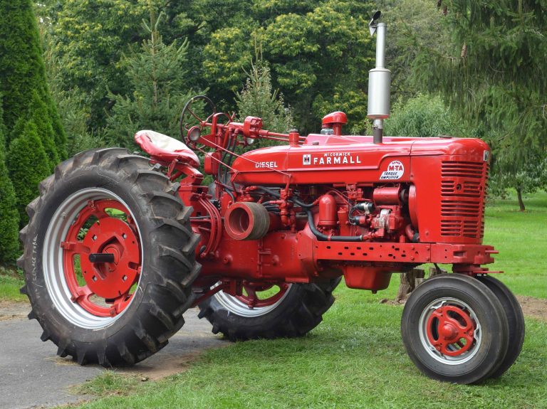

Took my honey for a ride yesterday, the cruise worked fine during the 3 hrs. we were out. Stopped for a bite to eat at a favorite little restaurant on the Fox River in a quiet little town not far away from our place. Afterward headed out on some country roads that had little to no traffic except for farm equipment we ran into. I can't help but marvel at that equipment now compared to when I was a kid. Back then a Farmall M was considered a big tractor, it wouldn't hold a candle to today's machine.

« Reply #9 on: July 04, 2024, 10:30:07 AM »
My brother has a fully working Farmall M tractor (and power takeoff and a bunch of attachments), and that is a big tractor.  He's got smaller Massey Ferguson and Ford tractors too.  And a road grater and a dump truck.  And his daily driver is a 1965 Dodge Camper Special.
He likes equipment and can fix anything, and won't pass up a good deal.
His Farmall is the lawnmower for his 40 acres.
