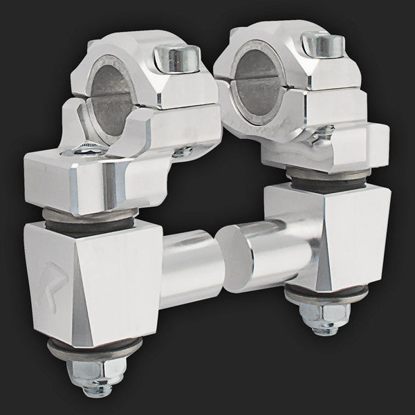

« Reply #7 on: August 11, 2024, 07:11:10 AM »
It looks like the Rox top clamps are offset inward, and the clamp bolt holes would not match up with the Valk top clamp holes.
2-inchers
Aside from the Rox pivot feature, they seems overly busy and complex, instead of just getting a taller set of risers (and using the Valk top clamp).
Or just use the supplied Rox clamps.

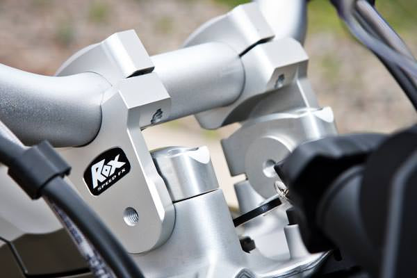

« Reply #8 on: August 11, 2024, 08:48:47 PM »
Haven't seen the clamps like the second photo.  Mine are like the first photo, and the bar clamps on the Rox align directly over the clamps of the original risers.  On both my Nomad and the VTX I use the original clamps with the Rox risers.  Can't see any reason you couldn't on the Valk, depending on the version of Rox you have.  Again, never seen the version in the second photo.  Second photo looks like you could loosen the bolt and spin the bar clamps outward if you wanted.
