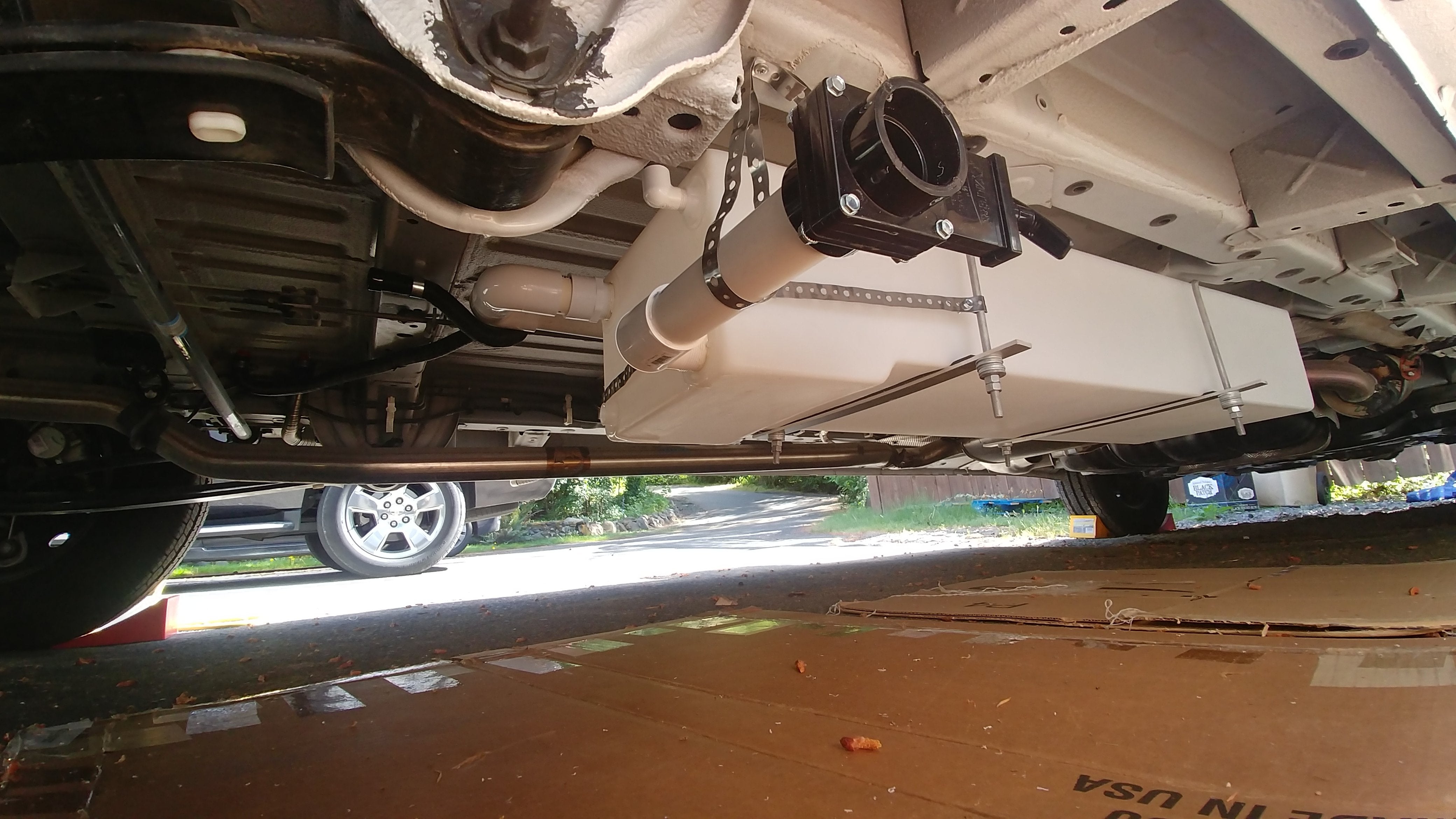

My Dodge Ram van (the only 4 wheeler I own) sits up so high, I can easily slide under for any work I might need to do (none yet).  I've never had a flat in the 10 plys, and never taken down the spare, though do keep the proper pressure in it.
Not mine (same truck)
I have no grey water tank, but look at the room under there.  I could camp out under it.   Grin

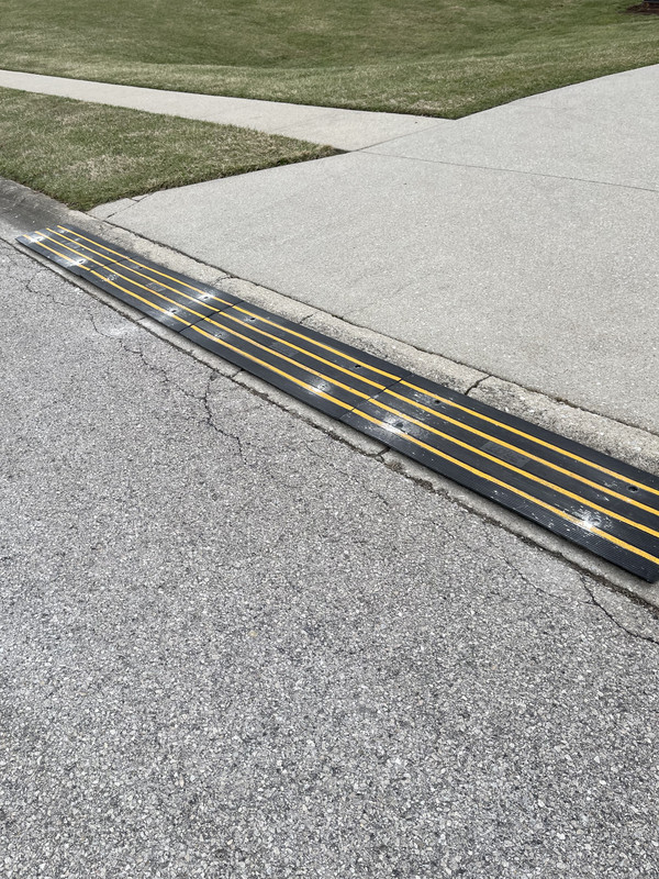

Installed my used driveway ramps that I bought off marketplace a couple of weeks ago. Gosh they make a difference as I drove the Vette over them today. The Wing will get its chance tomorrow. I’m sold and I’ll be keeping my eye out for another set for the front driveway.

Nothing like a speed bump driveway apron.
I got a 3 hr ride today in that low 50s weather.  Still nippy, but fun.  Some old speed bumps around (in my shortcut streets) here have lost all their paint and no signs, and if you don't remember them, you come clear out of your seat.  WTF!!???
You have a nice lawn there John.  cooldude   I bet you don't mow it with a walk-behind.
