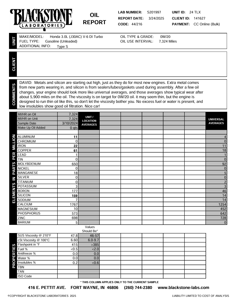

I found a simple alternative to guessing and worrying about the oil and filters I used: get the used oil analyzed. I switched to Quaker State for my F150 and the wife's Escape because it cost a lot less than the Mobil 1 I was using. The test results were the same. I switched from Bosch to the cheap Walmart Super Tech oil filters on my F6B and Valks. The test results were slightly better with Super Tech filters.
I'm curious how well the 0W-20 oil in my new car holds up so I just sent a sample to Blackstone Labs. I'll share the results. One nice thing on a Blackstone report is that they compare your results with other engines of the same brand and type.

The results are in. The 0W-20 OEM oil held its viscosity quite well, even after 7,324 miles. I planned to have the oil changed when I was in Arizona in January, but the dealer said Acura only pays for their 'free' oil changes when the maintenance app shows oil life below 20%. So I decided to change it myself when I got home and pull a sample for analysis. Like all Hondas, the Acura uses the same filter, drain plug, and washer as our Valkyries.
The wear metals are high, but that should clear up as the engine breaks in. I'm sure pushing the oil over 7K miles raised the levels. For comparison, I've included the analysis of another 6 cylinder Honda, my '98 Tourer, with over 176,000 miles. Hopefully the Acura will hold up that well.
Thanks for that numbers dont look bad in fact pretty good.  cooldude
Not bad, but I sure want that copper number to drop.
A big surprise is that moly number. Maybe Acura uses a different oil for break-in. I've read they do that for Goldwing final drives and also for the rear diff on SH-AWD Acuras.
Since they have have dropped the levels of Zinc in the oil I have recently tried the Redline Break in oil as an additive in the oil at changes. I use probably a 1/4 of the bottle for each change and have noticed a difference in smoothness and gas mileage. The government cut down on this vital additive because of the catalytic.
I have also used the Liqui Moly rear end moly additive and it works well in the diffs of the motorcycle and car. I also tried the Liqui Moly Moly additive for the engine and had mixed results. Had to take the bottom oil pan off the car and clean it because the additive did not fully circulate through the engine but collected in the oil pan making a deposit on the inside of the pan around the oil pickup.
I currently use the Moly Gen 5W/50 and really like it though. I immediately noticed a drop in temp of the engines I have put it in and the inside is clean as a whistle.
Your numbers should start to drop back to the normal levels as you get some more miles on it.

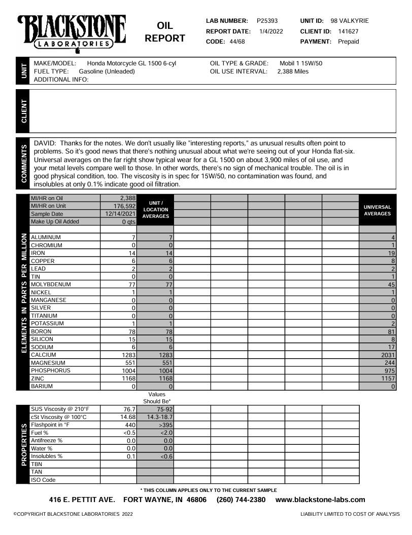

Was just looking at the Zinc numbers on the car and they are pretty low. But as you said maybe a break in oil.
Compared to the Valk which is more where I am used to seeing them be. Manufactures had to harden valve tappets and cams to get by with the lower Zinc numbers and have the engine live.
