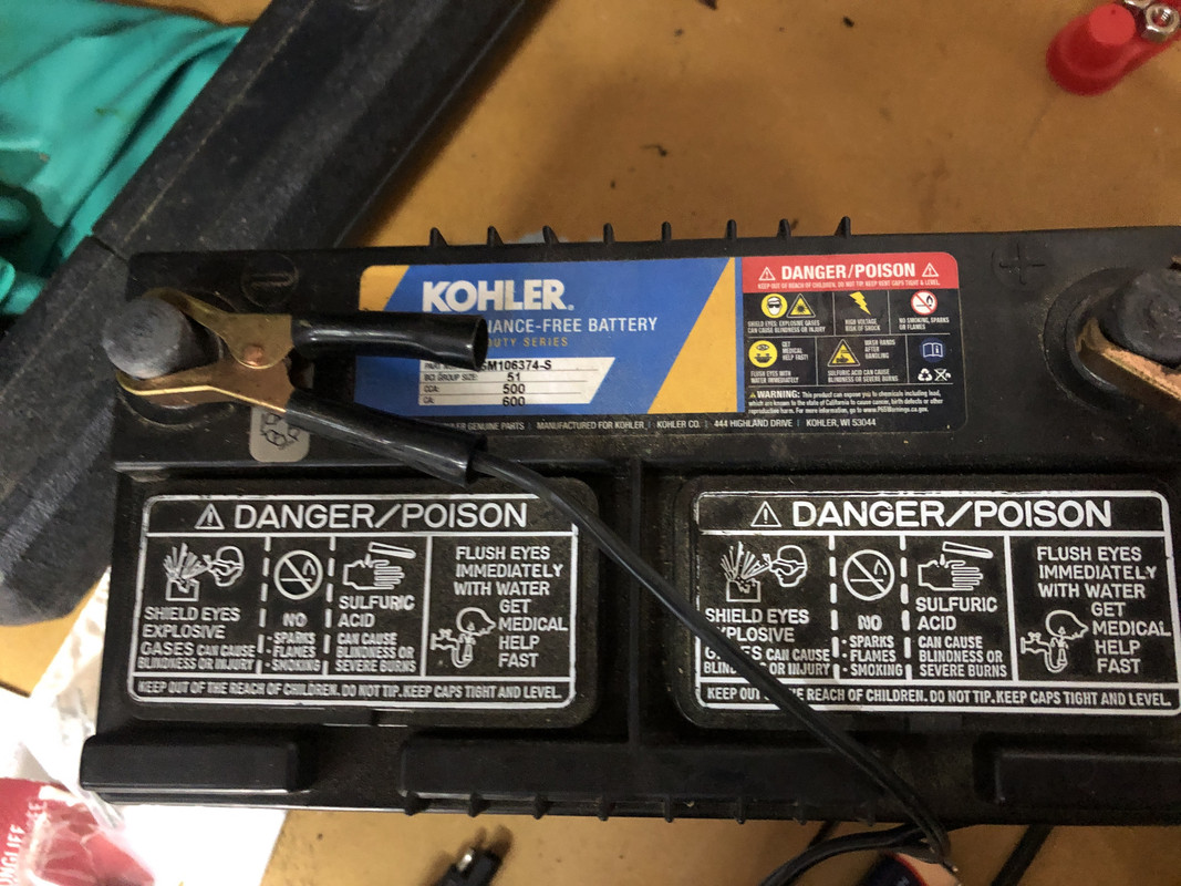

The original battery (which I still keep on a Battery Maintainer) is show below:
The question:
I have searched the internet using "Startpage" and searched sites like NAPA and Autozone for a Duralast Gold 51-DLG and I cannot find a store that sells one.  I have found 51R's but none that match the installed battery.
So, the question.  (well two questions).  What am I doing wrong in my searches?  And secondly, is a Duralast 51R an equivalent replacement?

My major concern was the 51 vs 51R and I just decided to do a search on that and found what I sort of figured but was not sure.  That is the "R" stands for "Reverse".  That is the battery terminals are reversed.  I cannot imagine that will be an impact on installation but it might hide the "name plate" data from view if I have to turn the battery around to align the terminals with the connectors.
Just did not have this problem when I did the first replacement.  So, alarm bells went off.

I went back to my files for the generator and found a picture of the installed battery (below).
It would seem that since a 51R just has the positive and negative terminals reversed, and given the way the cables are installed and connected, I should not have an issue using a 51R battery.  However, if the cable length is an issue due to positive and negative terminal locations, I will simply rotate the battery.
