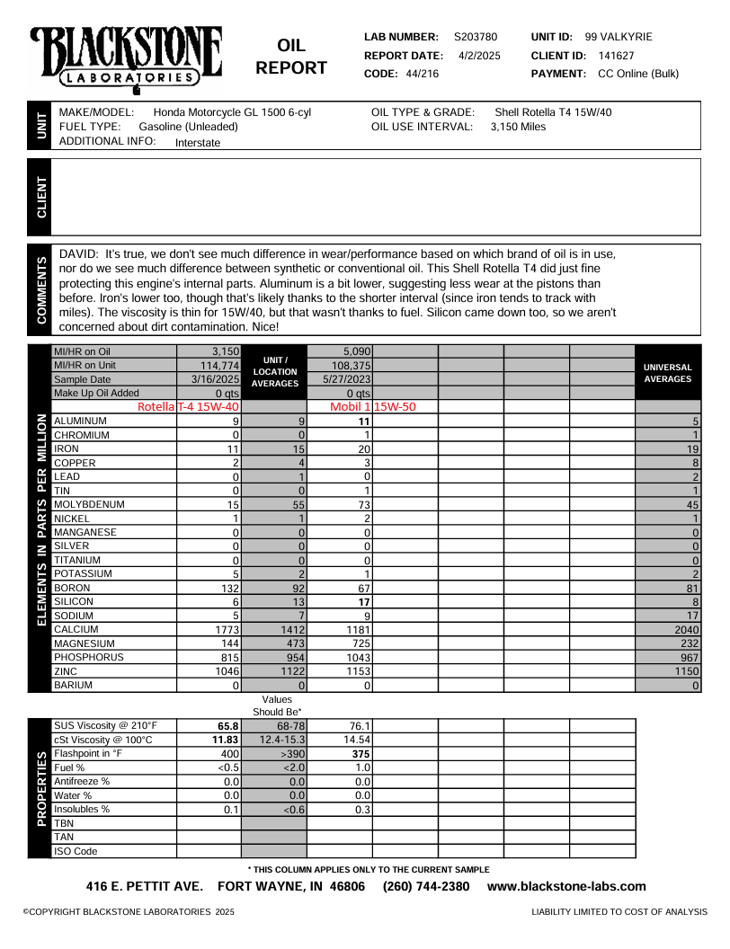

After reading convincing evidence that motor oil brands and types are very similar these days, I decided to switch from Mobil 1 synthetic to Rotella T-4 conventional in my '99 Interstate. I had the used oil analyzed with both for a good comparison. The conventional Rotella worked just fine. Wear metals were lower but that may be due to a shorter change interval. In fact they're better than the averages for GL1500 engines. The only downside was a loss of viscosity. It wasn't enough to be a real concern but I might not try running it for 8,000 miles. Have a look at the results. BTW I'm using those cheap Super Tech filters.

almost all oils in north american today are full syn or semi-syn. all of these low weight oils are full syn.
this engine is very low wear.  8 to 10k oil changes are not a problem. I do 10k oil changes. at 5k miles I drain the oil filter, then refill it, re-install it and then top off the oil level.
see wear limits.  https://en.oelcheck.com/wiki/limit-values-for-lubricants/
 F6Dave reports show almost zero wear when compared to the wear limits. both oils would have gone 10k miles no problem.
colder riding temps cause more raw fuel to get into the oil which reduces oil visocosity. getting that oil nice and hot to burn off the gas and acids is a must.

F6Dave
Posts: 2400
« Reply #8 on: April 03, 2025, 01:26:07 PM »
That's a good summary. I remember reading about that court case.
So what is the advantage of synthetic oil? Does it lubricate any better? Years ago I read that the hydrocarbon chains in synthetic oil are more uniform which somehow were more resistant to shearing, which made the oil retain its viscosity longer. All I know is the analysis showed that conventional Rotella protected my engine at least as well as synthetic Mobil 1.

F6Dave
Posts: 2400
« Reply #17 on: April 04, 2025, 10:43:45 AM »
When comparing the analysis reports after running two different oils in the same engine I noticed the following:
  • They have very different formulas. Mobil 1 has much more moly and magnesium while Rotella has much more boron and calcium. And of course Mobil 1 is synthetic and Rotella is conventional.
  • Both oils gave my Valkyrie the same protection.
Bottom line: use whatever brand you want as it will probably make no difference.

F6Dave
Posts: 2400
« Reply #29 on: April 08, 2025, 05:48:54 AM »
No scientific data to offer but I’ll continue to use Mobile 1 and Rotella T6 as long as I can afford it.  My first new car, a 1975 Monte Carlo, was run with Quaker State 10w30 and changed at recommended intervals. Some years later I had occasion to remover the valve covers on the small block 350 and was flabbergasted to find so much sludge that I don’t know how the oil was able to drain back down to the pan. The only explanation I can offer is that during that time the cars daily use amounted to short trips that barely allowed enough time to reach operating temperature. As I stated in another thread, my Titan which I have owned and serviced with Mobile 1 for the last 19 years, had a valve train that looked new when I removed the valve covers for the first time in 210,000 miles.
Quaker State was really bad about creating an excessive amount of sludge.
I don't remember exactly why, I think that it had something to do with one of the additives they were using.
Since Quaker State is now owned by Shell the formulas may be different. I know that Pennzoil, also owned by Shell, uses their GTL (gas to liquid) technology to make motor oil from natural gas.
