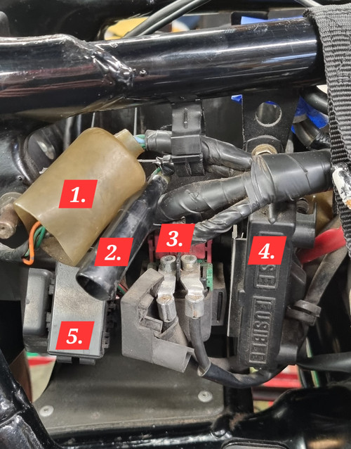

Am I able to access a Switched Live from the pic below, please? Do the numbers help?
I'm pretty sure I have done previously but I can't remember where. I sold the bike last year and removed accessories but now I have it back.
I need a Switched Live for sat nav lead and usb lead.

« Reply #1 on: February 23, 2026, 08:40:06 AM »
Behind #5 is a 5 amp acc fuse. It powers the two wires inside the #2 tube.
Knapdog
Posts: 358
South Wales, UK
« Reply #2 on: February 23, 2026, 09:07:27 AM »
Thanks.
So, should I swop the ring terminals on the lead for bullet terminals and plug in to the two female terminals in the no 2 black sleeve?
What about my usb lead?

« Reply #3 on: February 23, 2026, 10:11:31 AM »
Yes. Remember, it is a 5 amp service.

« Reply #4 on: February 24, 2026, 09:16:00 AM »
If I've got the sat nav sorted for No.2, I still need advice for a Switched Live for my usb lead.....

« Reply #5 on: February 24, 2026, 09:37:50 AM »
Parallel off the #2 and use it for both. A USB draws very little.

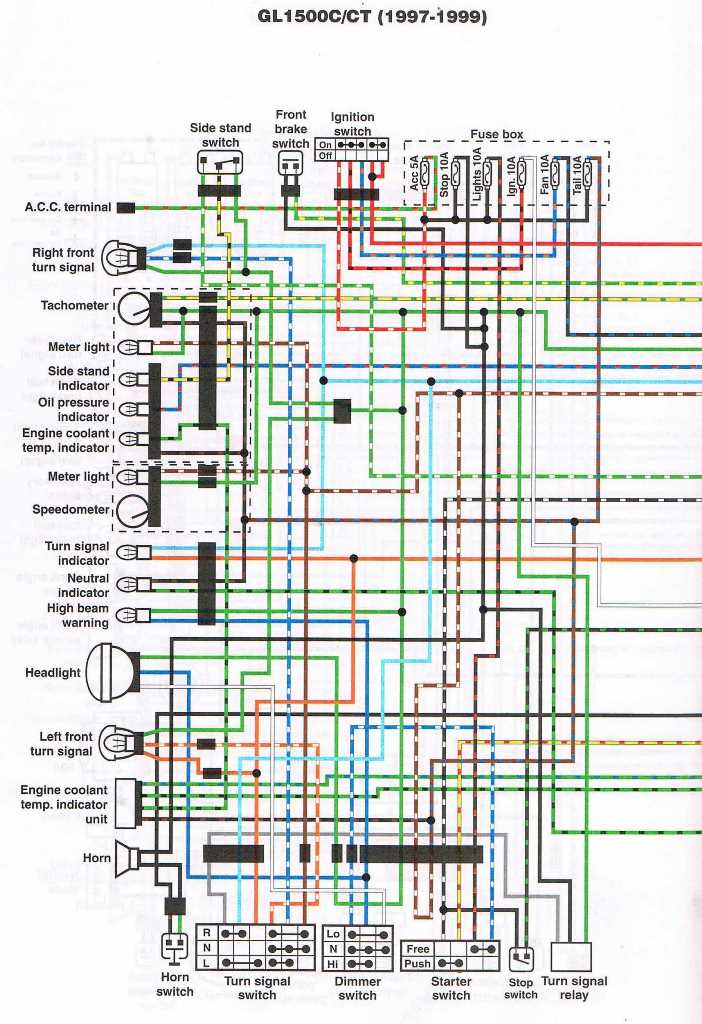

Here's part of the wiring diagram for an early Tourer. Looks like the acc terminal is green/orange (or maybe red). Grounds appear to be green. Clymer has easier to read diagrams than Honda.
F6Dave
Posts: 2385
« Reply #14 on: February 26, 2026, 08:03:15 AM »
If there's ever any doubt about a terminal you plan to connect to, get out a voltmeter and test those terminals before connecting anything!

« Reply #16 on: February 26, 2026, 08:29:12 AM »
OK.
I can see that, in the diagram, there's one red and green lead going back to the fuse box and then on go the ignition switch so that must be the Switched Live.
So, do I plug in my Sat nav RED lead to that and find an earth for my Sat nav BLACK lead?
I also have a solid Green ACC terminal lead as well. What would that be?
Also, someone has replaced the ACC 5amp fuse with a 3amp.

« Reply #17 on: February 26, 2026, 11:53:27 AM »
I can now answer my own question following a "Search".
The Green is EARTH.
The Red/Green is LIVE.
If I utilise those two terminals my Sat nav is up and running with the 3amp fuse in the fuse box.
USB probably straight to battery with inline fuse.
