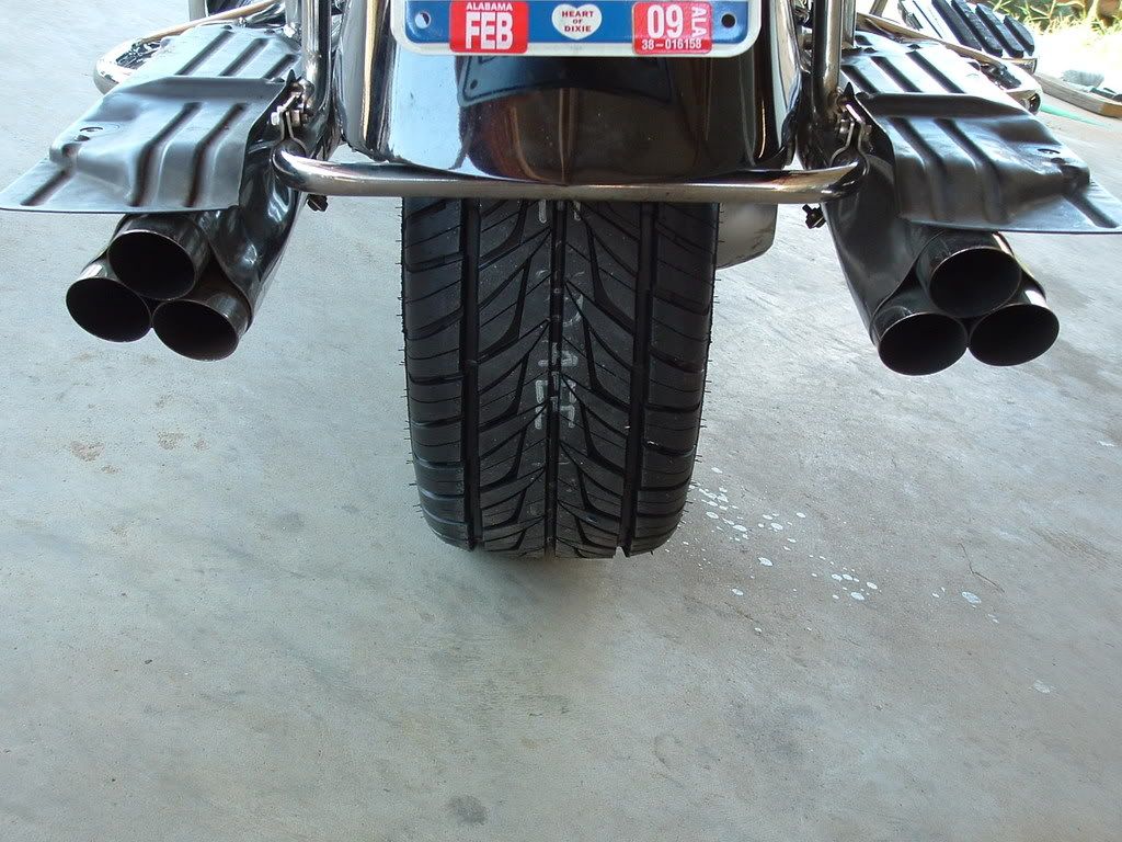

Bridgestone Potenza G109 Grid is most excellant. over 2000 miles and loving it.
stormrider
Posts: 1147
Kinsey, AL
« Reply #15 on: March 23, 2009, 05:48:33 AM »
Thought I posted pic. one more try. Bridgestone Potenza G109 Grid 205 60 16 at 38 psi. Has softer compound that most except the cooper zeon that Smokin Joe runs (and others) Liked the taller profile, a 60 as opposed to the 55 of the cooper.
