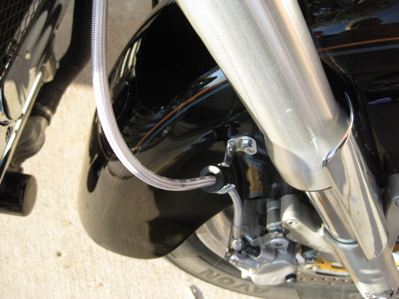

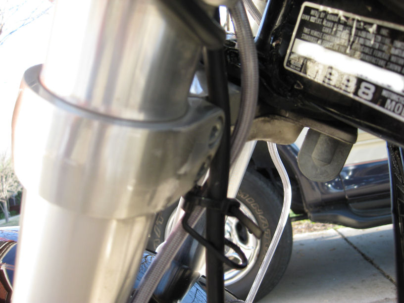

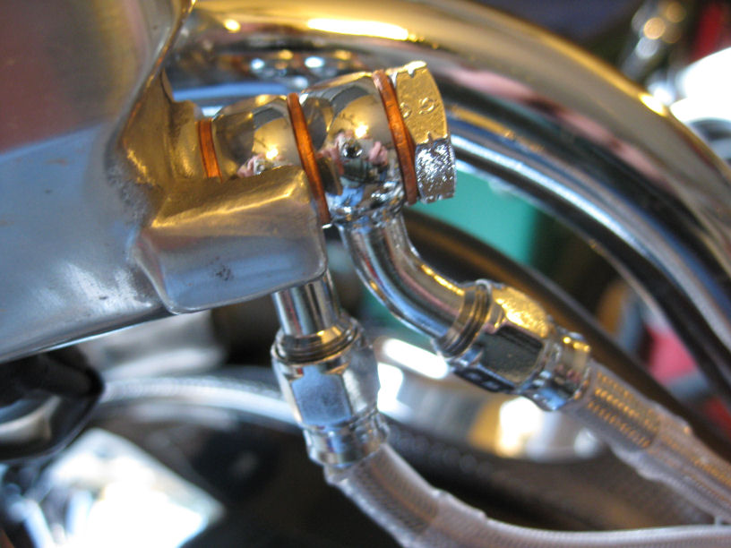

Here's some pics:
Individual right and left front brake lines connected to master cylinder.
Left side brake line zip-tied to existing retaining clip.  Line runs from cylinder on right handlebar, down the bar using existing ties, and under the headlight to the left side.
Rubber retaining grommet from old brake line.  Slit it lengthwise to get it off the old line, put it on the new line, then position it in the retaining clip with the slit toward the center of the clip (apex of the curve, in our terms.)
