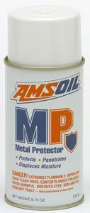

Posts: 6978
« Reply #13 on: April 09, 2010, 01:23:03 PM »
That is interesting....
I've used Amsoil's MP for years...
http://www.amsoil.com/storefront/amp.aspx
I'd have been interested in seeing how it faired against the others.
