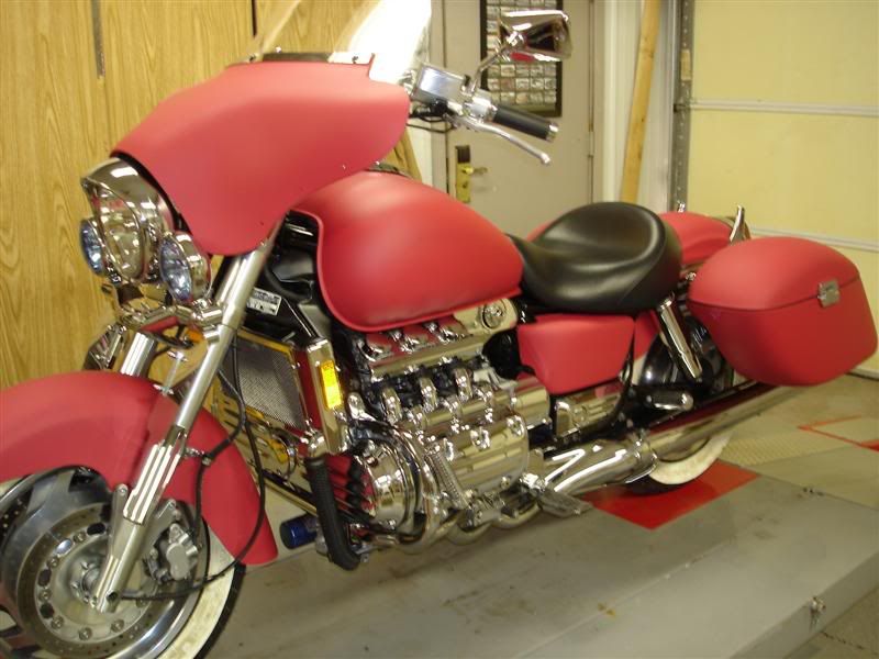

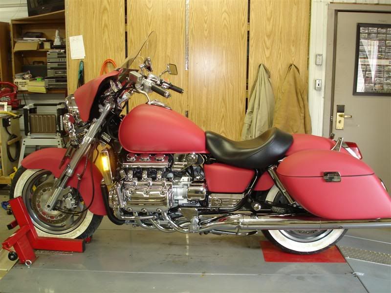

Ok,
I have spent the last month or two doing a face lift on my 98 standard, not that it needed it, the bike has only 12K on the clock and the tins were almost pristine. This all started when I bought a Memphis shade fairing  and a set of Jumbo Tsukayu bags. I decided to buy new tins because I could not take a sander to the original ones. While I was at it, I decided to go with an interstate tank.
What I was looking for was a bike that resembled an old school hot rod, a lead sled so to speak like the old 50 merc's, I think I got what I was aiming for.
In the last couple of months with the help of Blackdog, and Darryl from XF6 I have added the saddlebags, mounted a headlight extension from Darryl, mounted a new light bar, changed the front turn signals, installed headlight and running light relays, mounted the interstate tank,  installed a back off flasher, installed the airflow extensions, polished the wheels, painted the whitewalls, mounted the fairing added the 39 ford taillights and painted the bike.
The paint looks like primer, but it is actually base/clear urethane finish that happens to dry flat by design. It not only looks flat, the top coat actually feels like rubber, the closest I can come to explaining the texture is a brand new basketball. Only time will tell how it holds up!

« Reply #1 on: April 21, 2010, 10:25:12 PM »
That is one sweet looking ride.  Nice job!

« Reply #2 on: April 21, 2010, 10:55:07 PM »
i don't think there is a bad color for a Valk.
i like those tail lights!  cooldude

« Reply #8 on: April 22, 2010, 07:05:07 AM »
Looks really good, what grabs my attention is the White Walls. I didn't know you could paint tires to be White Walls. I always thought the rubber was impregnanted with the color. Is there any tips on doing this? I'll check tech board next.  cooldude

« Reply #10 on: April 22, 2010, 08:15:26 AM »
TONY,
This is my first shot at painting the whitewalls. Most people say it can't be done, I guess that is why I had to try. My tires are half or more worn so I did not have much to loose if it did not work out. To be honest, they looked great from about 5-6 feet or more when I first did them, but after riding I started to get bleed through so I will have to touch them up, possibly on a regular basis.
PLUS, it is not easy, and it is not cheap, and knowing what I know now, I would probably not do it again because of the amount of work involved, and the fact that they may have to be maintained or touched up on a regular basis.
Most people that try to paint whitewalls have a hard time getting the paint to stick to the rubber. I found a paint that sticks to the rubber, (SO FAR) but only after a great deal of sanding and prepping. The paint is a marine paint that is made to paint the rubber dingy's that hang on the back of they large yachts. It is sticking well so far, but I am getting some bleed through so I will have to touch them up, at this point, I am not sure if it will be a continual process of touching them up or if the whitewall will eventually hide the stains, time will tell.
Again, I would probably not do it because the paint was about $40 for a quart, I then had to buy thin line masking tape for another $20 (two sizes) to get good lines, and then I probably had 3-4 hours sanding and prepping each tire prior to the paint.
BUT, I managed to get the look I wanted, the only question is, for how long? We will see what they look like by the time Inzane rolls around!

« Reply #22 on: April 22, 2010, 10:26:55 PM »
JOE,
It does look a little pink in the pic's under the florescent lighting, outside or with the door to the shop open it looks darker, similar to the old red oxide red brown primer the hot rodders used years ago.
It is not actually the color I wanted, they sent me the wrong color but I sprayed it anyway because it was pretty close. I had a window of two days with near perfect weather to spray it coming up, so I did not want to send it back and waste 3 weeks waiting for it.
Jim

« Reply #30 on: April 23, 2010, 07:56:42 AM »
Ghillie,
I read through that web site when I was researching the whitewalls. The problem with their product is that they use an automatic buffing machine that cost a bundle of money, like 5 to 10 grand.
A little out of my reach just for a look.
Jim
Jim Callaghan    SE Wisconsin
JimC
Posts: 1829
SE Wisconsin
« Reply #31 on: April 23, 2010, 08:08:08 AM »
Cruzen,
I am still working on the wiring gremlins, I hooked up to the original tail and brake light on the fender separately through the back off flasher.
I ran the bag lights through a trailer splitter in an attempt to have run/brake/stop on the bags, but it looks like i may end up with run/turn wired from the original bike wiring because I am getting flash feedback into the bag lights. Seems the ground on the turn signal is part of the circuit, I am thinking that it breaks ground to make it flash? (ANYONE?) I am not a wiring guru either.
Jim
