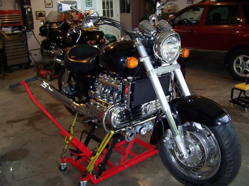

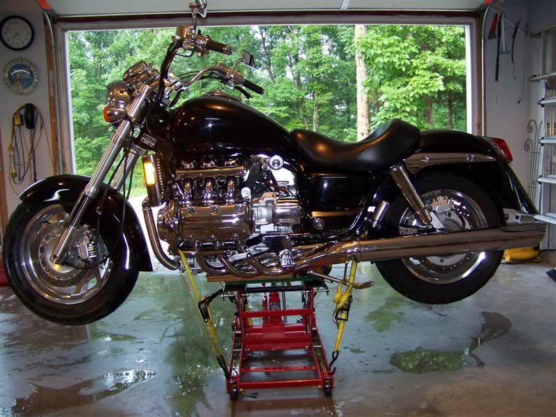

Some may know I bought this salvage bike an 03 Standard from a friend. It was totaled while he and I were on a ride. He had used his insurance funds to purchase a replacement and bought this one from the insurance company,with dreams of rebuilding it. Like many lately he came on to some hard times and decided to part with it. Since I had helped him at and after the accident ,and in finding a good deal on the replacement he gave me first shot at the bike. Thank you Harry . He did remove a few parts from it first, the Honda leather bags and support brackets ,driver and passenger floor boards was about all. The windshield folded back and destroyed both the speedo and tach, windshield bracket punched a quarter sized hole in the tank. Both front and rear fenders had some dents, rear license plate/turn signal bracket was tore up. exhaust headers were dinged up. passenger seat and backrest were torn.Thats about it.Totaled by the insurance co. So here she is,waiting to be inspected by Mo. State troopers on June 1st. They require an inspection before a salvaged vehicle can get a prior salvage tittle. Its pretty well a stock figured since the passenger seat and backrest were tore up I would go solo. I welded the hole in the tank ,and did the license plate under the fender ,cut a license plate bracket from stainless on a mill at work. ordered the leds and a new flasher from Custom Dynamics. Drilled the fender and mounted the Leds under the fender and flush with the outside surface, like the plate. Finished project cost  $2000.00  YAY!

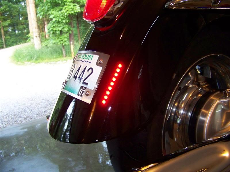

« Reply #1 on: May 20, 2010, 07:34:21 PM »
I like what you did with the turn signals.  Those look good in the fender.

Yep, good to have friends. He sold it to me for pretty much what the insurance co. sold it to him for,after subtracting the used value of the parts he removed. No doubt it was a good deal. Even if it had been only used for parts.When I got the bike from him it had sat for about 6 months.with a large hole in the tank. It was bone dry. I was still nervous about welding it .So it was flushed with soapy water,rinsed and re-rinsed.Then misted with oil to hopefully deter rust.I am still keeping an eye open for a I.S. tank.I do appreciate the complements, most anyone who has seen it complete had no idea what they were really looking at. DoubleTee sent me some reservoir covers and brake and clutch levers back when we had the garage goodie give away ,thanks. I actually removed a lot of the items the insurance co .scraped out. the seat, windshield, passenger back rest,saddle bags I think I will wrap the headers with the black exhaust wrap,to hide the small dings under the bike. As far as the resale value goes,I know it will never sell for what it is worth,My I.S. is a salvage I bought back about 5 yrs ago. I hang on to my stuff. Just ride it. I may not put the miles some of you do but I won't own a garage queen .The I.S. now has 75000 on it . Can't wait to put some on this one . Thanks again to every one. I'll see some of you at the whiskey run !
