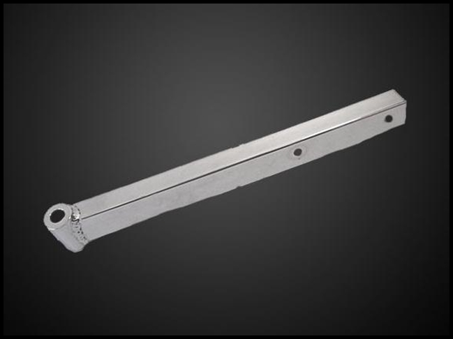

I have been looking around for a while to see if I could find an easy way to adapt an SO-239 based Diamond/Comet triband ham radio antenna to my I/S and to Blondie's 'TourerState' (Tourer with an I/S trunk and antenna mounts). The problem lies in that darned 8MM male stud arrangement which Honda/Clarion seems to be in love with. No one offers commercially an adapter, and I was even thinking about fabricating a new antenna arm with a Diamond SO-239 mount in place of the OEM setup.
Earlier this evening I was playing around with my junk box full of connectors and a spare GL1200 'Wing OEM antenna arm...and I observed that the nylon washer and stud of one of these:
Will fit into the mounting barrel of one of these, being locked into place by the pictured coupler nut. The nut on mine was rounded; not hex...so it had adequate clearance on the inside of the "barrel":
And a second SO239-stud-washer setup can be screwed into the bottom, locking the works together and enabling one to feed the antenna with a PL259-equipped cable.
The barrel on the mounting arm is exactly the same as the one used on the I/S' Hondaline AM-FM and CB antenna mounts.
