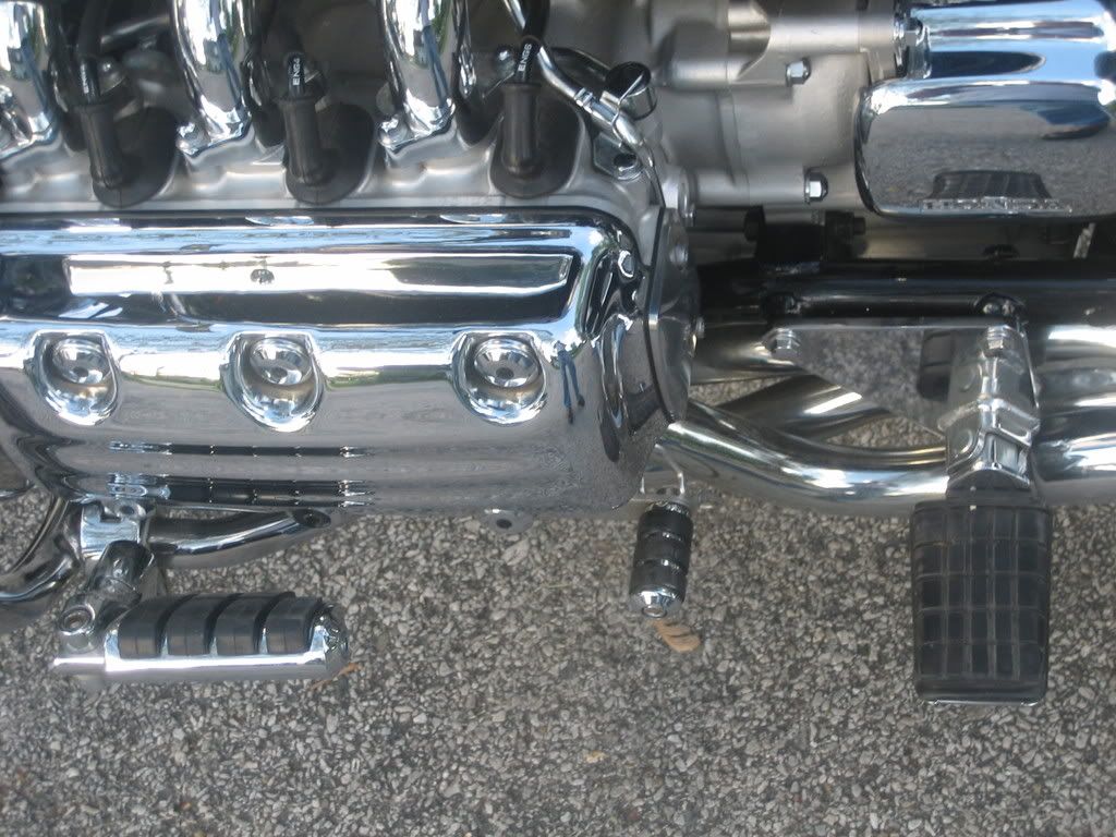

I design this for my bike to work with the Rattlebars kickshift setup. I think the Rattelbars kickshift is about the best one out there. It kinda floats on the exsisting shift peg stem and works very well.
